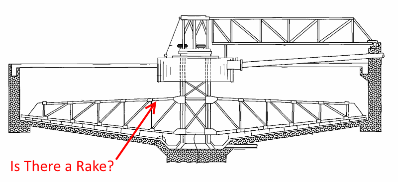

Does that tank happen to have an internal rotating rake, also?

If there is a rake as suggested by SlideRuleEra, columns cannot be used at all. That would be a whole new ballgame.

There isn't a rake. This is a clearwell built in 1950s for a waterplant and it's just holding water. Drilling through the existing concrete would make it difficult to seal it after, but if that's the only way then we have no choice. With pouring the new slab on top of existing one, I'm more worried about the new concrete sliding on top of the old one as the vertical pressure will be high. I"m thinking to specify HILTI rebars embedded in concrete, but that's such a low penetration I'm not sure if it works. Do you have any recommendations?
