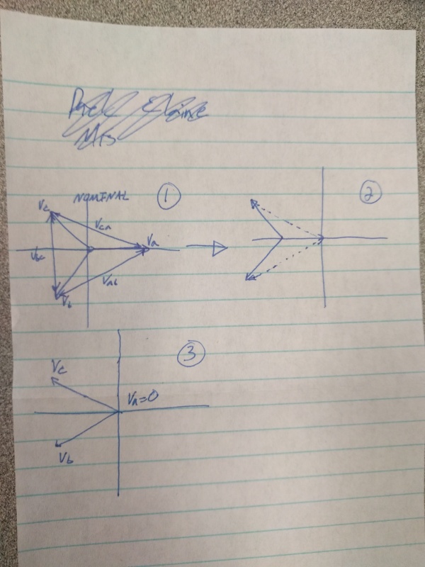

This image is how i had it explained to me that helped me understand this. Remember that the generator is trying to maintain the same potential difference between poles. So if one pole is shorted during a ground fault you get the effect of sliding all three over.
Clay
Pardon my quick sketch isn't so good but i'm a visual person.

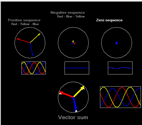

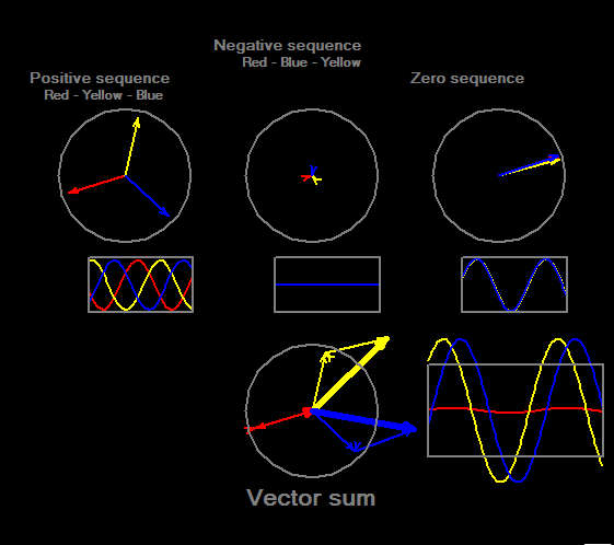

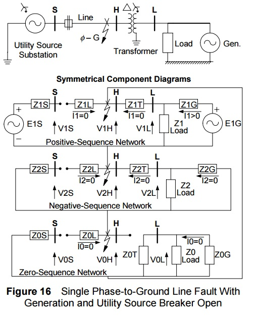

During a SLG fault on an ungrounded system, the ground point shifts from the neutral to the faulted phase. If you look at the diagram below, no current (I1,I2,I0) can flow for the fault since the zero sequence network provides no return path. The voltages on the ungrounded system ,however, will change as the result of the fault and this can be seen by transferring the sequence network voltages at H ,in the diagram below, from the sequence domain to the phasor domain. The voltages below at point H are V(positive) = E1G, V(negative) = 0, and V(zero) = -E1G. If these voltages are transferred from the sequence domain to the phase domain, the ground has shifted to the faulted phase and the line-to-neutral voltage on the other phases has increased to the line-to-line voltages and the angle between the two line-to-ground phasors has reduced from 120 to 60 degrees . No negative sequence voltage developed to change the line-to-line voltages (open circuit sequence network) ,which are unaffected by zero sequence.
Unintended ungrounded system situation that happens on our system.
Varying amount of zero sequence voltage.
Sequence network for an SLG fault.
Voltages on an ungrounded system with a SLG fault.

The GIFS were put together using Alex Eachern's Power Quality Teaching Toy. It is what I use to get a visual idea of how sequence domain relates to the phasor domain and oscillography. It is worth playing with to get an idea how the two domains relate to each other.
