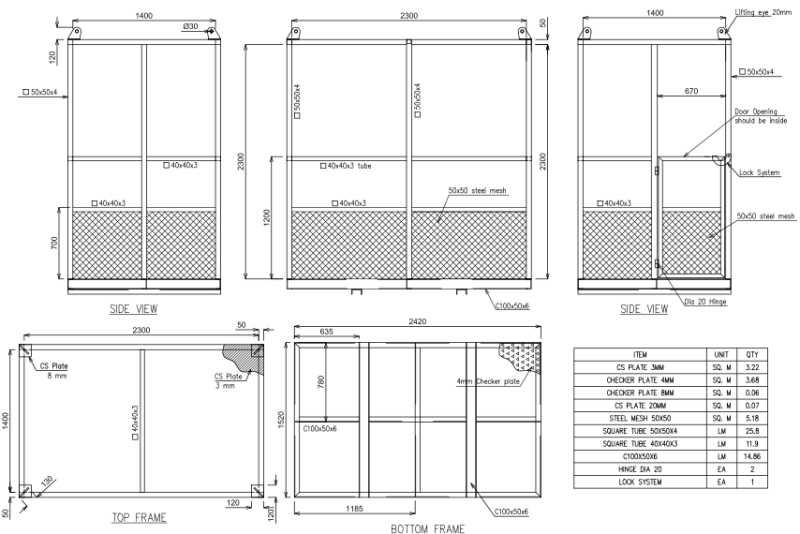

Is there any specific code/clause specifying on what loads are need to be consider on designing a 4 man basket lift?
Check your applicable worker safety regulations (e.g. OSHA).
You might also have separate governing regulations for crane suspended loads (e.g. ASME below-the-hook).
And if a major contractor is using the basket lift, some of them have their own in-house rules.

Where are you located? There are very likely applicable codes, but you need to let us know where you're located before someone can point you in the right direction. A few things you should be aware of:
- You'll need to provide at least 4 fall arrest tie-off points in the basket
- Prior to each new working condition, often these manbaskets need to go through a trial run with the crane to test its range of use. You may need to provide a test weight equivalent to the capacity of the basket, along with an easy connection to attach/remove the test weight.
- Your sketch shows 4 lugs, which would be the primary lugs. You may also need a 5th lug for the secondary line, which would be sized for 100% of the self-weight and occupants.
