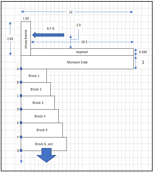

I am designing a segmented block retaining wall with a barrier on the top. The top of this retaining wall is a road and the barrier, according to TL-3, will have a 54K horizontal point load to account for the impact from a car. I have designed a spreadsheet that will calculate the bearing pressure if it were just a simple retaining wall with a simple back slope, but I am unsure how to handle the point load in the bearing calculation.
I currently have been attempting to add the vertical point load (Pveh) with the two other horizontal forces from the soils (Ps) and the surcharge loading (Pq) to get a total P. But this approach is giving me bearing pressures that are extremely high which makes me believe I am doing this wrong. If there is any code or material related to this, I would be more than willing to read but I have been unable to find anything so far.

I apologize for not stating, those are the (Ps) and (Pq) are the pressures generated on the retaining wall by the soils and surcharge respectively. The active pressures acting upon the wall. I am not sure if you are to combine these pressures with a point load but I know when I calculated my Moment-Overturning and Moment-Resisting, that the vehicle point load was included. The retaining wall is not what is stopping a vehicle, the barrier wall sitting on top of the retaining wall is what shall be resisting the force.

I attached an image with the current diagram of the situation. I don't have a free body diagram on the computer but I can upload my hand calculated FBD if the image is not enough.

We'll need a sketch of the cross section showing how and to what the barrier is anchored, how far away from the wall facing the barrier is, etc.
If you're looking at the bearing pressure below the reinforced backfill, there shouldn't be any increase in vertical bearing pressure due to a horizontal impact load.

I have attached a quick calculation I did for the bearing wall. The calculations for just a simple retaining wall without the vehicle impact load was shown in the "Design Manual for Segmental Retaining Walls." I took these calculations and attempted to design them for this situation.
I am really not sure how the point load on the barrier will be transferred into the retaining wall which is my main area of concern.
I don't get it. Where does that HIGH vertical load come from when you only show a horizontal load AND DO NOT SAY IF ANY OF THESE UNITS (BARRIER AND BLOCKS) ARE SECURED TO EACH OTHER? Without the barrier secured to the wall below, you will depend on its long "beam" horizontal bending resistance and very little friction at its base. Also throw in the inertia of a barrier wall sitting on something, not tied down. That inertia for a long length of the barrier might be all you can work with. Since there has been double posting,my other posting comment indicated that if the barrier is a continuous concrete wall, adding anchorage to the top layer of blocks will significantly add to the inertia resistance to any horizontal impact to the barrier wall.
See the AASHTO LRFD bridge design spec., Section A13. According subsection A13.4.2, I think you could use the yield line failure length, Lc calculated in A13.3.1 as the distribution length.
If it was me, I would abandon the block wall and just do a concrete retaining wall that extends up to provide a barrier, eliminating the moment slab. Alternately, Keystone and other manufacturers provide help with designing block-faced MSE walls with integral barriers.
The barrier is designed for 54 K. The wall is designed for a 10 k impact force that is distributed along the length of the moment slab between expansion joints, not to exceed 30'.
