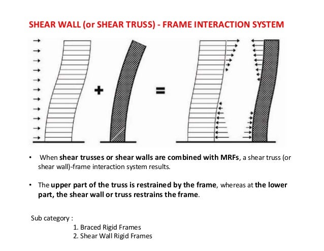

Another example might be a dual structure, with RC walls and RC moment frames, of which the two systems have quite a different fundamental behaviour on their own than when combined as part of a buildings lateral force resisting system. Put the two systems in series and the deflections at each level must be compatible, and forces develop between the two systems to maintain this compatibility.
Edit - like this image for second case
