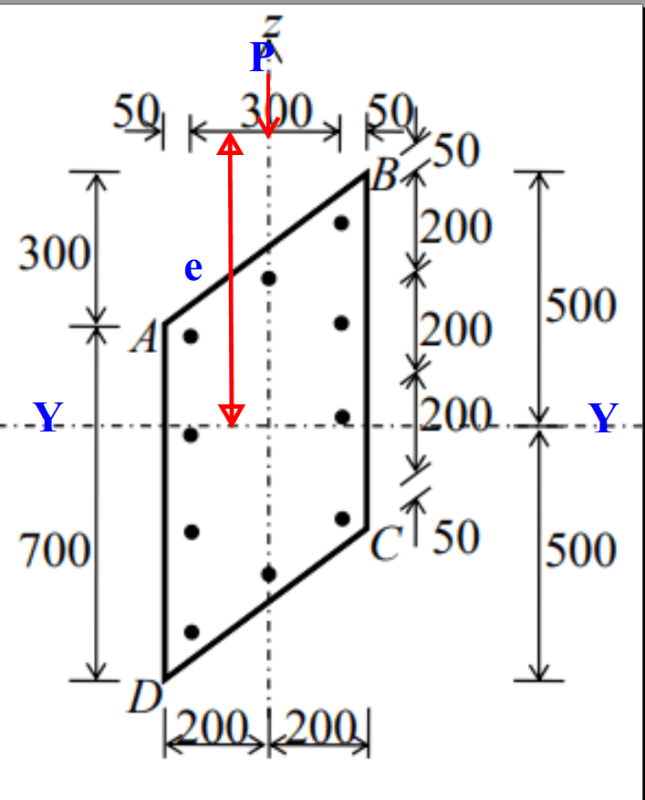

Hi
I have an irregular shape column as shown below. I am a bit confused. Is NA going to be parallel with y-y axis or side AB. I thought point B will be most compressed part of the section. Is there any recommended book covered irregular columns?

OK,ignore my previous post.
If you apply a moment about the YY axis in your diagram, the resulting stresses must have zero moment about the perpendicular ZZ axis. The only way you will get that is if the neutral axis is parallel to lines AB and DC.

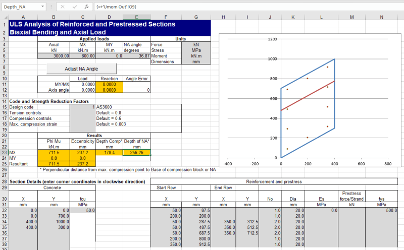

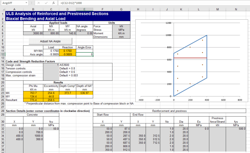

My biaxial moment spreadsheet will work for this problem, but it needed a bit of adjustment to deal with the case of zero transverse moment.
You can enter applied moments and click the "Adjust NA Angle" button to find the Neutral Axis angle and location. For zero transverse moment the angle is found to be exactly parallel to the top and bottom faces:
Or you can enter a neutral axis angle (for instance zero), then use Excel Goal-seek to adjust the MY value so that the Angle error is zero:
Link for spreadsheet download
