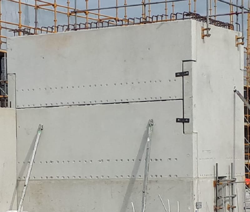

I am using shear friction for shear transfer across panel to panel joints in a seismic wall project. To use a value of 1.0 for µ, Table 22.9.2.4 calls for 1/4" amplitude. I have read somewhere in the PCI material that on green concrete, a heavy sandblast will achieve sufficient roughness for µ = 1. I have a 3rd party review which is asking where I found that and now I cannot find it again.
Anyone know of any documents talking about intentional roughening by sandblasting?
