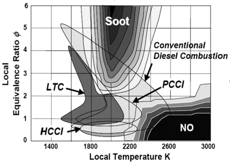

Low Temperature Combustion (LTC) using Homogeneous Charge Compression Ignition (HCCI) is a well known (if not yet mature) strategy to clean up soot and NOx. You can get a sense of how much work is being done in this area by entering "HCCI LTC site: (sans quotes) into Google.
Here's a chart showing the relations between equivalency (a value of one indicates stoichiometric). Note that NOx results from high temperature while soot results from running rich (which is unavoidable when fuel is injected into hot air).
I agree with others here that the current system of contraptions used to improve efficiency and reduce emissions is too complex. I've spent a good deal of time working to devise a simple form of HCCI LTC. It's not yet clear if I have been successful.
As for alternate fuels, I think the front runner in the race to save internal combustion has to be those that employ existing delivery infrastructure such as higher ethanol and biodiesel blends. Anything else requires a huge rebuild of infrastructure, and if a huge investment in infrastructure is required, we may as well go all-electic IMHO.
