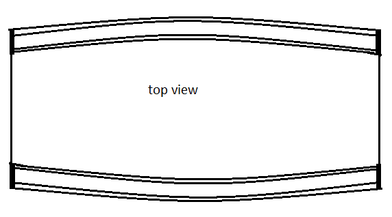

Hi guys,
I have a water tank with a depth of 4 meter and planar dimensions of 9X4 meter squared
the problem when it is filled with recycled water to a depth of 3.5 m, what happened in reality that the tank bloat and the walls tend to bend to the outside, I am thinking of a retrofitting method, which is using steel beams to brace the tank from the inside at two levels , all connections will be hinged and no weld to be used for corrosion prevention purposes.
I check the beams for tension and the plate for von mises stresses
I thought of using IPE200 beams screwed to the water tank walls with double angles, the screw is similar to what is used in sheet to purlins connection, I think the bolts should be qalvanized and a special material should be applied to prevent any leakage from the holes.
I am worried about what i came with, do you have any concerens or shall I proceed?
The material of the tank is steel plate with 6 mm thickness. and the water in not potable.

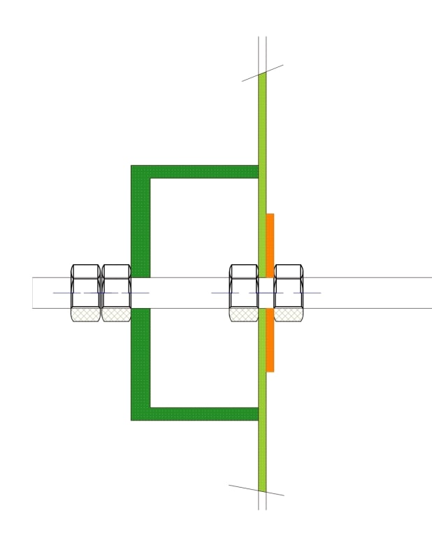

External full perimeter stiffening elements would be the more conventional way to do this. Run angles, horizontal plates, or WT members continuously around the tank perimeter at whatever vertical spacing you need to hit your deflection target. Alternately, you run a perimeter stiffener along the top and bottom, and then span vertical stiffening elements between them. You can add ties between the top beams on opposite sides if you want.
There's two major problems with what you've proposed. You've created big stress concentrations at the points where the tie beams connect to the tank wall, which is problematic with plate walls. On top of that, the bolted connections will be a reliability nightmare.

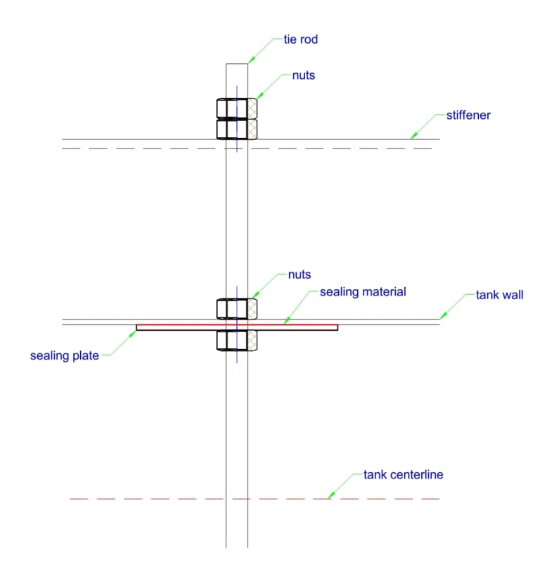

The proposed beams are acting as tie-rods. If you are going to drill holes in the walls of the tank, just use rods instead of beams and thread the ends.
As mentioned, stiffeners on the outside of the tank are the usual approach.

The problem is that when beams at two levels were welded at the exterior face of the tank, it didn't solve the problem and the water load bent the beams to the outside. This is an actual problem happened in reality, noting that the supporting beams were only connected to the tank wall at the corners.

Not necessarily. If you weld the entire circumference of an open profile (WF, C-channel, ...) in a correct way, there will be no problem. Bolted connections, drilling holes through the wall, single-sided welds, ... are all asking for trouble.

If you want tension ties only, you have several significant problems to overcome. I'm guessing you will have 20,000# of tension as you have it cartooned. Not appropriate for screws. To make the forces manageable you will need those tension ties every couple of feet in each direction. Maybe a whole mess of rods as CompositePro suggests. You could probably install a bearing plate on the outside where the rods bear and do some kind of two-way analysis on the plate. You didn't mention the plate composition or thickness.
Why would you only attach it at the corners? You lose all composite action doing it that way, and will significantly affect the ability of the retrofit to control deflection?
Also, for something like this it's definitely economical to continue the stiffeners around to the short ends and do a moment connection at the corner to reduce rotation there as well.

Internal stays would more commonly be rods than structural members, for ease of painting, etc.
Note that you may get high bending stresses in the plate at the stays.
Internal stays clutter up the interior, making it harder to perform work in there.
without any calculation, only a suggestion but no welds (i.e. tie-rods threaded at both ends, stiffener as U-channel)
