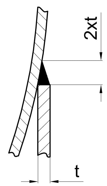

Our client has asked us to include joint efficiencies for all welds in the weld maps. However, there are some welds that I do not know what joint efficiency is to be assigned to them.
From Table UW-12 I can see he following note:
ASME BPVC 2015 VIII-1 Table UW-12 note (5) said:
(5) There is no joint efficiency E in the design equations of this Division for Category C and D corner joints. When needed, a value of E not greater than 1.00 may be used.
1- the weld of skirt to the bottom head
2- the reinforcement pad for nozzles. It looks like a category D but I am not sure if a joint efficiency can be assigned to that since it is not a butt weld.
3- many other welds like for example skirt to base plate, sleeves in skirt, lifting attachments,...
Many of these weld do not have a formula in VIII-1 including a joint efficiency but for the design of their welds I have to assign some efficiency to them. Is it the joint efficiency to be reported or do I have to say joint efficiency is not applicable for the attachment.
