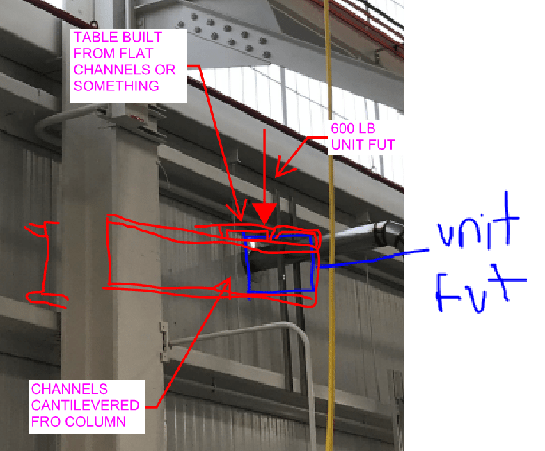

Hello,
I have a weird situation in which I have a 600 lb mechanical unit to support in the air. The weird part is that I can only use one column to support. Please see attached photo for more clarity. I thought of putting 2 inverted knee braces on column one leg vertically (say y-direction) and another leg horizontally in the x-direction. From the horizontal leg, I thought of putting 2 horizontal unistruts in the z-direction. From there on putting 4 vibration isolation rods into the mechanical unit to support it. Unistruts can be braced and horizontal legs of knee braces can also be braced to stop torsion.
I thought this model to be good but the only issue now is the rotation of the unit and hence the rods. How do I restrict that? Can someone provide some suggestion this?
Also you can suggest alternatives if you have to support the unit in air with the column. it will be really appreciated.

600 LBS isn't all that much so you've got some options. I'm afraid that I don't understand your proposal however. It might be prudent to post a sketch.
I too need a better sketch of what you are describing. Also, you need to make sure your future unit is somewhat to scale. The size drawn on the picture looks kinda small for a 600 lb mechanical unit.

Can they move the equipment "up" some in your drawing to at least align with the column to the right? If not, you have a bi-axial headache one way or the other. Assuming the column is strong enough you could somewhat apply Kootk's drawing 2 times with the column being at the 90 degree corner of a triangle. Provided you cantilever enough, you could connect a platform between these 2 cantilever arms. I am not sure how much vibration goes on but you would be cantilevered at least 7' to 8' based on your drawing.
I tried but I don't think the unit will in any way be able to align with the column so can't use Kootk's method.
Well we aren't Wizards/Witches, at best we're magicians the way we can fool the eye to see what they want. Some cases however, the trick just can't be done.
I might be on board with something like Koot's proposal. Cantilever something off of the column (preferably a tube section) the long direction such that it puts the column in mostly strong axis bending. Then cantilever a platform off of this tube such that the tube is seeing bending and torsion, and the main column sees bending in both directions.
Without running numbers I don't know if that is truly feasible without major reinforcement, but it's a thought.
