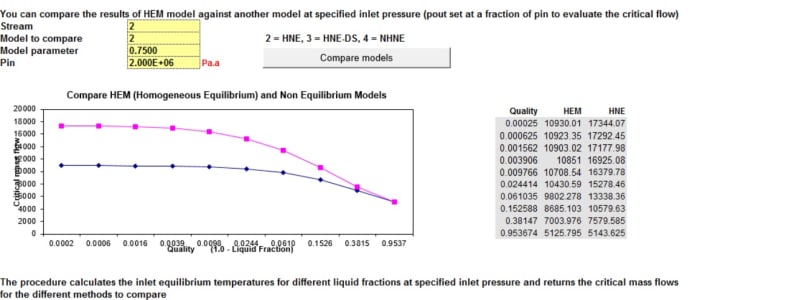

the mentioned (see my previous post) non-equilibrium models, can include a non-equilibrium factor to take in account boling delay and similar behaviour (for additional information, see the paper),
the distribution of Prode Properties includes a Excel page which allows to compare results from different models, for example HEM (Homogeneous-Equilibrium-Model) vs. HNE-DS (Homogeneous-Non-Equilibrium with boiling delay) etc.
I attach a scrreshot to show the differences
In this case, with a initial condition close to a bubble line, there is the so called boiling delay but other non-equilibrium conditions may happen as well...
