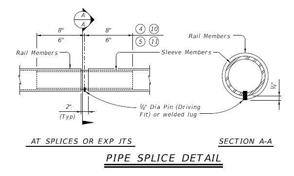

You can do a 'pipe inside a pipe' splice, which allows movement.
Below is a detail from a TxDOT pedestrian handrail.. I've seen this on smaller fall protection rails and it seems to work well.

Thank you for the replies and the detail, Joel!
