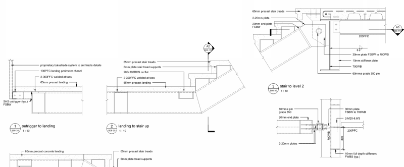

I think you guys are on the right track. One thing to be careful of is your perfect truss model usually has the up and down stringers offset. This creates a lot of twisting to deal with the eccentricities. So make sure you explicitly model this effect.
This one below was designed all fully welded with continuity members going back into the landing. Ensure you model everything to capture the twisting effect and as Kootk noted imposing the drift on the stairs is pretty critic step. For a stair you might consider imposing not just the ultimate limit state drift but instead the maximum credible earthquake as if there's a stair failure its a critical part of the egress system.
It certainly should be considered in the design but, for the sake of deformation compatibility, I actually think this is an asset. The added internal flexibility means less force generation for the same inter-story drift. The thing can just twist all cockeyed at the landing and life carries on.
I guess, the eccentricity creates a lot of secondary actions such as moments, torsion etc that needs to be explicitly considered and not ignored is my point.
I take back what I said about there being continuity members back into the floor, I found the detail and refreshed my memory, it was pinned top and bottom a big arse pin with a continuous structure consisting of both flights with lots of interlinking members. They ended up with a pretty substantial box section made out of 300 channels, and some lighter members on outriggers out to the edge to give it a lighter architectural look.
See below:-
Edit:-
One other thing, at midheight landing they had ties back to some columns to deal with the seismic load/drift orthogonal to the flights, don't forget about the load in this direction:-

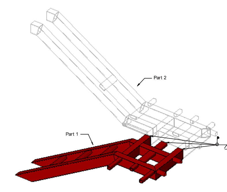

Please forgive my ignorance KootK, still having trouble determining exactly your method. I've attached an image of my understanding of it.
From the image, you could back-calculate the moment required to give this rotation and then design the member for that?
 https://files.engineering.com/getfile.aspx?folder=a49697d2-5068-49cd-a59f-fb02926211ab&file=KootK_method.PNG
I see where we've gone off the rails now. I was thinking of movement parallel to the stingers where your concern seems to be movement perpendicular to them.
