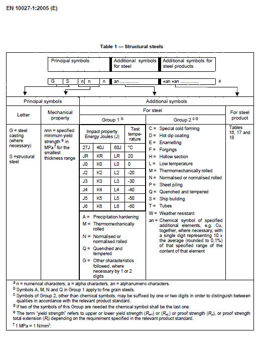

Hello,
I am working on an international project and considering using the European HE Beam - HE160(B) for a skid frame.
The steel was identified as: HE160(B) S275JR04.
I found out the S275 refers to 275 N/mm2 Yield Strength.
I had no success finding information on the "JR04".
Please advise meaning of JR04 as referred to above.
Thank you.

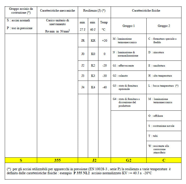

Designation according to EN 10027.
example : S275J4 (not JR04)
S = normal steel for structural use (not for pressure vessel)
275 = min yield strength (N/mm2)
J04 : min 27 joules at -40 °Centigrades (resilience - Charpy test)

Note JR04 could mean JR steel rather than J4 as robyengIT has stated.
I would assume JR as this would be a conservative assumption (lower fracture toughness), which could be important depending on the temperatures your structure may experience over its design life.
