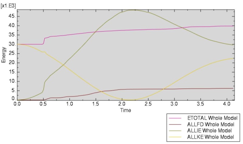

So I have performed another simulation and I plotted the energies shown in the attached figure. The total energy is increasing and I am in the final stage of my research and I am kinda panicking from these results.
Any idea why the total energy is increasing and the internal energy is large. Also, I have frictional dissipation energy is large as well.
Is it because the mesh is not fine enough? Or is it because the hourglass effect since I am using C3D8R?
Any suggestions? Thank you in advanced
To check for hourglassing compare ALLAE and ALLIE. The first one should be a very small fraction of the second one.
Large changes in ETOTAL are also alarming (they can be caused by exceeding the stable time increment). This total energy should remain approximately constant (not necessarily zero, especially that you probably use initial velocity which results in nonzero initial ETOTAL and positive initial ALLKE). But in this case it's not that bad.
ALLKE vs ALLIE is important but in case of quasi-static analyses where kinetic energy should be very small compared with internal energy. So it needs to be checked when mass scaling is used to make sure it's not too large.
ALLFD is caused by sliding in contact interface.
Thank you FEA way.
If I have my time incrementation type is automatic, it should take care of the stable time increment and adjust it. What confusing me is that I have another model used it in a similar analysis (impact simulation). The only difference is that the mesh in the second model is much finer and the material is different as well. The ETOTAL in the second model (with fine mesh) is approximately constant which gives me confidence in the model. I have generated both models in a similar approach and as I mentioned that the only difference that I could tell is the mesh and material properties.
Change in ETOTAL indicates some instability but (since this change is not large) if you carefully perform other standard checks and find no errors then I think that you don't have to worry about it. However, it would be good to refine the mesh in this model as well.
