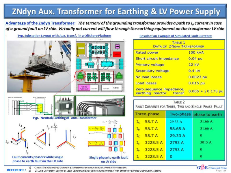

1) The goal of this project is to connect from a 33kV delta system to a wye earthed (grounded) 400V auxiliary power.
2) The neutral/earthed transformer suggested by the client is a tertiary transformer with a buried delta winding. (Should the designation be ZNdyn11 instead ZNyn(d)11?
Assuming that the suggested transformer has a buried delta winding (ZNdyn11) this configuration has advantages over the ZNyn as indicated in the illustration below. The zigzag portion of the transformer help to reduce the harmonic content generated by the system.
Due to the expected high harmonic content because of the nonlinear load connected in the secondary (UPS for navigation light, computers, communication equipment, battery charger for DC power system, etc.), it is not unusual size the neutral feeder with the same size of the phase conductor. However, an engineering assessment or calculation it is suggested.
I hope this helps.
What is the advantage of this over a Dyn connection? Is a ground source needed on the 33 kV side? Is the phase shift of a Dyn connection a problem? The Zndyn connection needs the delta tertiary to provide a ground source for the 0.4 kV system. Without the delta tertiary, a ground source is only provided on the zig-zag side.
GENERAL: wind power plants (WPP) are characterized by feeders with larger capacitance than conventional OH lines. The WPG also generates significant harmonic distortion and exposed to transient overvoltages, transformer saturation, power factor, reactive power, and voltage control issues.
The optimal design of the 33 kV and 0.4kV systems can be achieved with the proper selection of the neutral grounding/earthing auxiliary transformer. It is recognized that neutral grounding can be achieved in variates of connections such as YΔ, ZNyn, ZNdyn, ZNzn.
The best performance and cost for each application should be evaluated as well as the familiarity and experience for this application. In the USA, the most frequent application for a neutral/grounding transformer is Dyn and simple zig-zag unit. In Europe, the experience gained in several offshore projects favors the use of ZNdyn neutral grounding transformer for WPP.

1.3 The low zero sequence impedance of ZNyn & ZNdyn is an efficient way to mitigate the triplen harmonic (3[sup]rd[/sup], 9[sup]th[/sup], 15[sup]th[/sup]...)
This might be a project requirement and a potential safety issue in a metallic platform for an offshore substation application. In general, the ground source facilitates the ground protective device coordination and monitoring of the system in the event of SLG fault.
The 30[sup]o[/sup] phase shift of the Dyn by itself usually is not a problem. Special attention needs to be observed for connection to a standby generator to the LV bus for black-start, emergency or parallel mode.

Zero sequence impedance of ZNyn transformer for SLG faults on 400V side could be as high as 50% I read in a text book. Thus, the current will be as low as twice the rated current of 400V winding for SLG fault.
Adding a tertiary delta winding will help overcome this limitation. In case of systems with harmonics, it is important to size the tertiary delta winding generously to allow circulation (trapping) of the triplen harmonics in delta.
