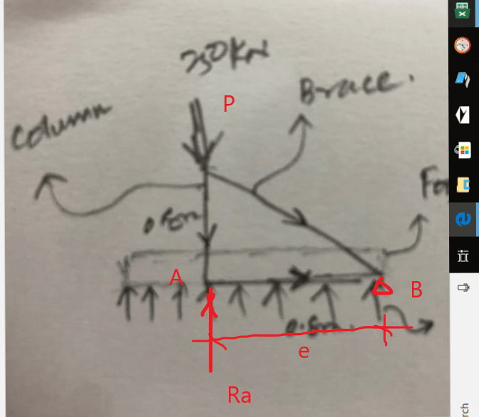

Good Morning Everyone,
I have got a project wherein the client wants to make an additional floor over the existing ground floor structure. When checked, the footings need to be increased in size due to additional loads. The client also doesn't wants to extend his footings on all sides and insists to extend to one side only(as he has some installed machinery inside). The client engineer suggest to provide a knee brace to transfer the load from the column to other part of the footing. IMO, that's not going to work. Would like the other engineers to give their views on the same. A rough picture is attached for reference. Any other data can be shared if necessary.
PS: The load and dimensions shown in the picture are not accurate.
Even with a knee brace, the force will still go straight down.
On top of that, footings are complicated to reinforce and usually don’t work like people hope they do.
Thanks a lot JLNJ for sharing your views, that's what I also interpret for load transfer.
But the client engineer ask me to give reasoning why the load won't transfer through the knee brace..[mad]

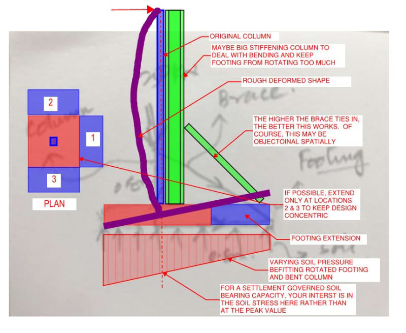

Consider the point where the top of the kneebrace meets the column. For there to be any force in the kneebrace, there needs to be something to resist the horizontal component of the brace force. Since there is nothing to resist this force, there can be no force in the kneebrace.
This is one of most simple and basic principles in the Universe - Newton’s Third Law. Forces follow Newton’s Laws, not arrows drawn on the paper.
Ask the client's engineer to get Ra for the support system shown below (hint: ΣMB = 0).

I feel that the key to understanding this situation, and explaining it to your client, lies in recognizing that this solution could be made to work with the right combination of parameters. It's just that that combination of parameters is likely to be extreme, costly, and spatially intrusive. Consider the following ways that one might arrange things to make this work:
1) You could have the brace tie in at the floor or roof above above.
2) You could make the column massively stiff.
3) You could accept a non-uniform soil bearing stress.
4) You could have a super low soil modulus. You don't want this, though, so we'll not discuss it further.
And definitely be mindful of the warnings that others here have provided about the settlement that would be require to engage the footing extensions, even if those extensions were concentric. In addition to the settlement required to engage the extensions, some of your settlement will also be baked into the cake by virtue of the load in place at the time the footing extensions are constructed. You might actually be able to use this aspect of things to your advantage. If your client were able to accept 2" of settlement instead of 1" of settlement, perhaps no footing remediation would be required. This strategy, of course, requires input from both your geotechnical engineer and your client.

Kootk, always great to see how you try to help everyone with your outstanding knowledge. Your comment almost clears all my questions actually. Thanks a lot.

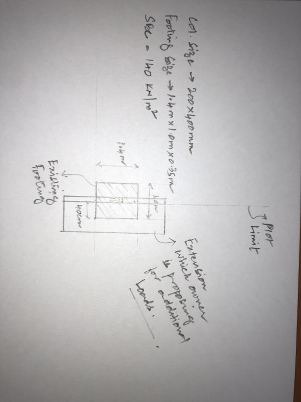

Kootk,
There are some more limitations to the problem.
As per the image shown, they just want to extend the footing on one side(red line). Also, there is plot limit and they can't extend their footing more than 400mm from that(black line).
Sounds like you may need to go back to MI Engineer's suggestion. If you don't have room to add enough concrete to balance it out, you'll need piles. Helicals (or a comparable solution that's locally available) will probably be the best choice.
So you have an eccentric footing to start with (column adjacent to/against the property line). If you can transfer some load to the new post as shown by KootK, depending on the amount load, even extend the footing on one side maybe just worked out. You can estimate the bearing capacity using existing configuration, then use it to design the new extended foundation. Also, instead of the kicker, I prefer the footing in a truncate trapezoidal shape to spread the load more evenly to the ground, provides that lateral load is not a major concern.
I may not have fully appreciated the original condition here. I had assumed that it was a column bearing on a concentrically placed footing. Was the original column placed at the edge of the original footing to begin with? What rectified the eccentricity in that condition? What kind of column are we talking about here? Steel? Concrete? Wood?
Surprise, yes. But KootK your proposed solution would still work for this case.

I am sorry that I couldn't explain my situation fully. Attaching a picture with a hand sketch again for understanding.
Nope, the old footing is an concentric one. The allowed limit to extend the footing beyond the plot line is 400mm on roadside(which has already been reached). However, the client says that he will get some sort of special permission from the authorities for more extension if the design is feasible.
Columns are concrete columns, the whole structure is RCC.
