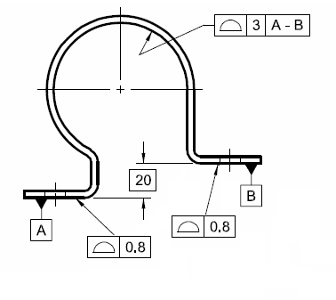

Since we're on the topic, what do you think about a directly toleranced width combined with a 2X datumless profile tolerance directed to the surfaces to control mutual parallelism?
I would say that even though this would probably be the best option within currently existing rules, I would personally prefer to avoid mixing profile with directly toleranced dimensions as this could still potentially create a confusion as to whether the profile tolerances don't indeed control spacing between the faces (especially in MBD world where basic dimensions are very often not shown at all).
I would rather like to be able to use something more straightforward (although here some may say that datumless orientation isn't straightforward at all).
Beside, would you have a similar proposal in case of a group of multiple nominally offset and parallel features (flat patterns of features) where the intent would be, for example, to refine orientation between the features within the group?
As for fig. 4-22, I would say that removal of "2X" would cancel the requirement for mutual location of the surfaces because the pattern creation mechanism would no longer exist.
It seems to me that the figure shows a toleranced feature with a fully-defined true profile (two planar surfaces with identical outward-pointing normal vectors and 20 mm separation), so I don't see why the idea of patterns needs to be involved here. I don't think removal of "2X" would change the meaning.

Without 2X, and with the existing definitions of pattern and simultaneous requirement, and with the fact that the profile tolerance have no datum references, the basic 20 dimension is meaningless when it comes to describing the relationship between the two profile tolerance zone. It just describes nominal/perfect condition.
As for usage of SIM REQT, yes this is always an option, but we (chez311 and me) don't really see a reason as to why orientation tolerances could not be added to the simultaneous requirement rule by default.
pylfrm,
I agree with pmarc, do you take a different stance that multiple leader lines is not just a "number of instances" notation and imparts a different meaning than the control attached to the multiple leaders applied to each surface separately (per my 6 Feb 20 14:53)?
If not, are you saying that there would be a requirement for the true profile of each planar surface in 4-22 to be basically oriented/located if the control were applied to each surface separately - like the below? If so I'm not sure I agree.
I don't really see why the idea of patterns needs to be involved in ASME Y14.5-2009 at all.
Do you mean just in this specific instance, or generally?
I realize that the pair of surfaces wouldn't be classified as a pattern per para. 1.3.42 without the "2X", but I don't see anything in Section 8 making that classification relevant.
I figure the simultaneous requirement rule isn't involved here because we are only dealing with one single-segment feature control frame. Regardless of what it's applied to, I wouldn't call it "two or more geometric tolerances".
Aren't the tolerance boundaries supposed to have a uniform offset of 0.4 from nominal/perfect condition, also known as true profile?
I see leader lines (whether single or multiple) as one of several methods available to specify what portion of the part a tolerance applies to.
For conformance to a single tolerance, I'd say there must exist an alignment between actual part and basic geometry that allows the entire relevant portion of the actual surface to fall within the tolerance boundaries. For multiple individual tolerances, I'd say a separate alignment can be used for each tolerance unless they are part of a simultaneous requirement.
