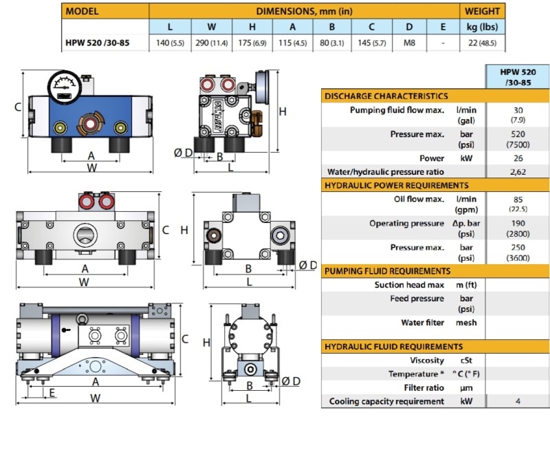

The output will drive a reciprocating piston pump (dynaset 520 which is more commonly used as a pressure washer)
We are using the pump to perform pressure tests so it is beneficial to drive the reciprocating pump at its maximum flow until the test pressure is reached

Here is a link to the Dynaset 520
Here is a summary of the specs

So the equipment that we supply will have a pressure and tank supply from a host piece of kit (a triton xlx) which is in effect a subsea HPU. This pressure and tank is fed into out valve pack (solenoid valves on a gallery) but they are NG6 with a max flow capacity of 40 Lpm but as you can see from the dynaset spec it can take 85 lpm.
So my question is can this NG6 proportional pressure/flow valve be used to drive a valve with a higher flow capacity to draw the 85 lpm the dynaset needs

Good - it's a small point but infact the pump is actually comprised of a hydraulic motor and a pump in one body. The data sheet states the discharge side and the hydraulic input side. The issue being is that I initially thought you had an electrically driven hydraulic pump, not a hydraulically driven water pump.
