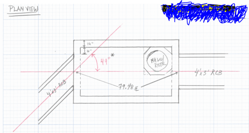

I am working on the design of a junction box connecting two RCBs. The RCBs are both 4x3. The flow is the same for both RCBs.
Due to the height of the entering & exiting RCBs, the I am calculating that the overall inside height (excluding top & bottom wall thickness) needs to be 4'-6".
Is there a criteria for Junction Boxes that states the minimum required inside height? Do workers typically enter inside junction boxes?
Any suggestions/ comments are appreciated.

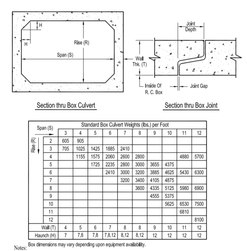

RCB = Reinforced Concrete Box (culvert)
See Image of RCB's below:
Reinforced Concrete Box Culverts (RCB's)

See plan view configuration of Junction Box with RCBs below:

I was thinking that 4.5 ft would be too short for someone to enter inside the junction box. It seems to shallow. I was thinking about adding an additional 2 ft to get the inside height to 6.5 Ft. So that someone can actually stand inside the box.

Thank you. Based on the detail, it appears a clearance of 4'-6" is sufficient for the interior of the junction box.
I agree that 4.5 ft is pretty short. If you have room for a larger box, then definitely bump it up.
Often times the box height is strongly influenced by flowline elevations set by the civil/hydraulic engineers. They will have their flowlines set at a certain elevation and if you suggest lowering them to get more headroom in a box; they will freak out.
