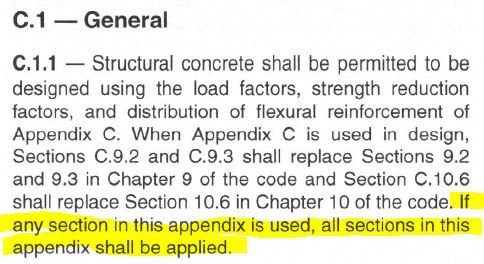

I would go through the trouble of deciphering Appendix C equations/conditions, run the calcs, and see which would be the most conservative. it has been a few years since I delved into these, maybe someone more current with ACI 350 could shed some light.
I could be wrong on this, but the ACI 350-06 Appendix items are design methodologies left over from older versions of ACI 350. They are 'grandfathered in'
Basically, ACI says "if you like the old load factors and method of calculating the sanitary coefficient, then you can keep using it"
If you are going to use Appendix C though, make sure you read Section C.1.1. It says that if you use the methods in the Appendix, then you have to use ALL the provisions in the appendix. You can't mix and match current rules with the older methodology in the Appendix.

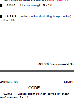

Also I have question on this following. I could not see this in ACI 350-06 whereas ACI 350-01 has mentioned this.
Is this still valid?
Akshiks,
It (1.3) was called hydraulic factors to further increase the load intensity after load combinations. If you are working on water way works, you should make sure it is lo longer apply (US Corp of Engineers for instance).

ACI 350-06 and ACI 318-14/19's basic load factors are in agreement. The only difference is that ACI 350-06 will apply an additional Sanitary Coefficient (Sd) on top of the basic load factors. The Sanitary coefficient will always be greater than or equal to 1. This ensures that a design done with ACI 350 will always meets the strength design requirements of ACI 318.
I haven't used ACI 350-01 but I assume the 'S' factor is equivalent to the 'Sd' factor in ACI 350-06 §9.2.6 which is the durability factor. You should read the commentary but in summary this factor is used to reduce the overall stresses in a concrete member to better control cracking.
The Sd factor is technically applied to the design load to increase it (as JoelTXCive sayid it has to be > 1.0) but I use it to reduce the design strength (same thing but putting it on the other side of the equation capacity > demand). This is because for shear only the shear carried by the shear reinforcement and not the shear carried by concrete is affected by it. So for a wall for instance you wouldn't include the factor for the shear design since usually you just thicken the wall to get the required shear capacity from the concrete but you would include it for the flexural design of the wall.
