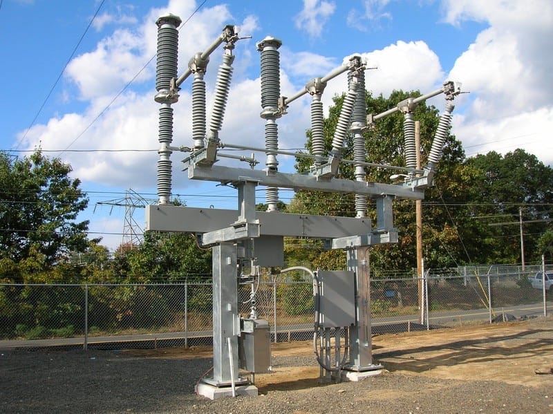

Are you thinking of a circuit switcher with integrated motor operated switch?
If this is what you are referring to, the horizontal interrupter between the middle and right vertical insulators is a SF6 circuit breaking device. It operates first on a trip (electrically and mechanically), then the motor operated switch opens. Closing is the opposite. Some use these on Transformers or Cap banks. Notice the external Live Tank CT's. Some may call a circuit switcher a poor mans circuit breaker. The vertical interrupter design are sometimes handy when space is a premium in front of a transformer. Generally the transformer has internal CT's for 87T and 87B applications.

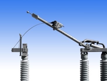

[sub]Some utility facing an economical dilemma and provide a low-cost alternative using a disconnect switch with load-break capability using breaking accessories with mixt results like the following devices added in the switchblades:[/sub]
* High-Speed Whip: Typically used attached to air switch to interrupt transformer magnetizing and line charging current.
* Quick Break Whip: Difficult to specify the exact level of interrupting capability. Increase switch line dropping capability by increasing the speed of contact separation during the opening of a switch.
