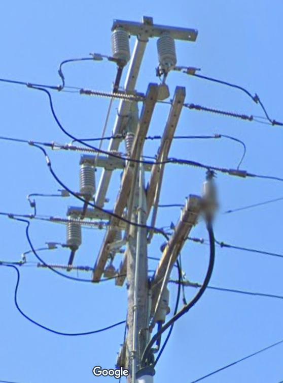

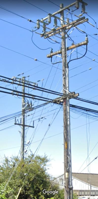

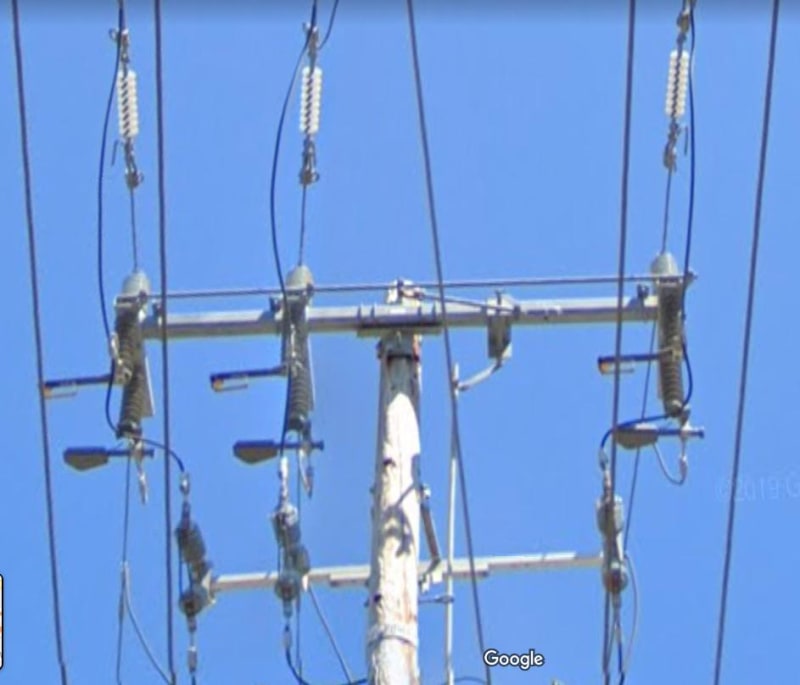

Curious is this what you're referring to?
Both these poles have manual switches.

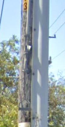

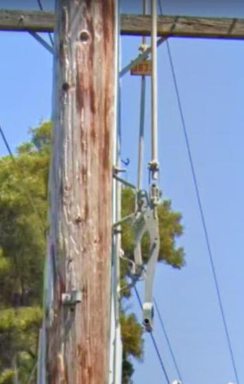

The handle
The Switch.
Across the street handle, side view.
Across the street switch different view.

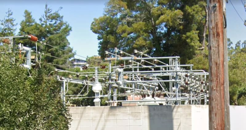

Interestingly enough there are four of these around this little substation which is now completely empty. There is nothing inside the walls now.
We have a couple of old step down stations the same way. We converted the circuits to 25kV coming out of them and use the switches for back feeding.
