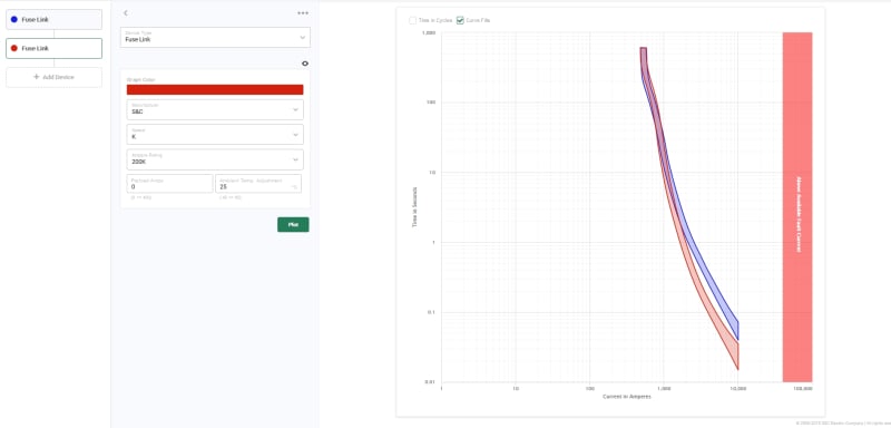

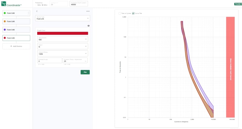

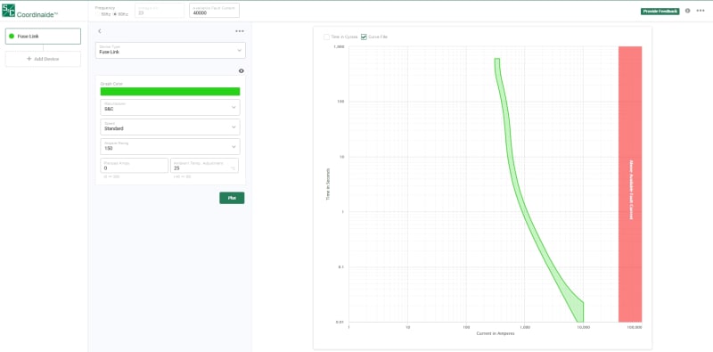

Type 200T and 200K links both start at around 480 amps when cold, mostly identical except for the notable shift towards to bottom.
Now, here is the interesting part. N links start at 408 amps, less than T or K links -BUT- the lower part of the curve is is nearly identical to the K link closing following it.
Finally the S link, starts at 366 amps, and is "faster" than than the 3 other fuses.
My question is, why the different pickup settings? I can understand the speed factor, but why start some links below 200% while others at 250%? Why would this matter enough to factor it into the engineering of the link?

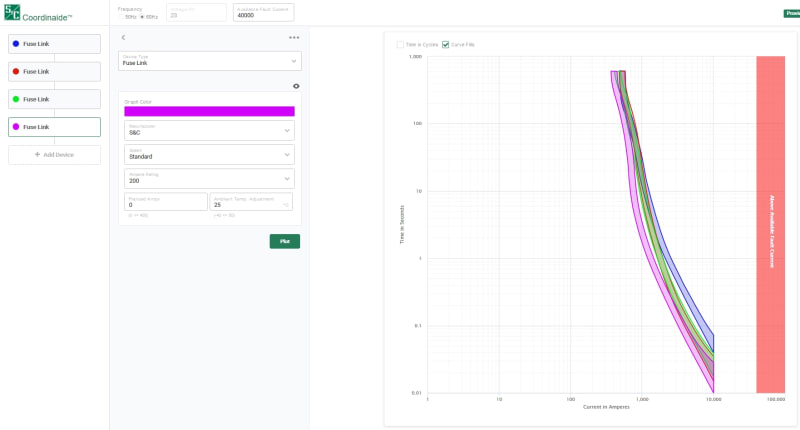

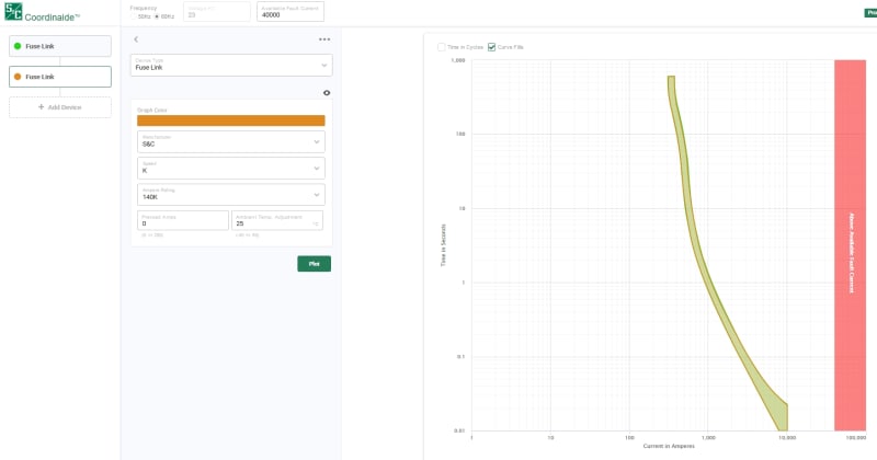

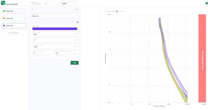

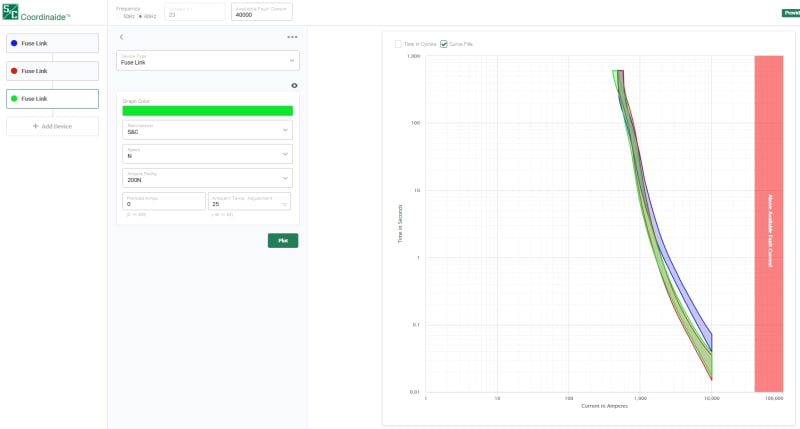

Ok, now I'm really in the twilight... 140K, 150N and 150S links all have an identical time current curve which literally overlays (into one another) identically without showing bare color?
S and K link overlay:
S link:
K, S and N overlay, purple is T link:
T link overlay with K and S:
Does this mean some links are identical just labelled differently? I suspect that to be the case?
