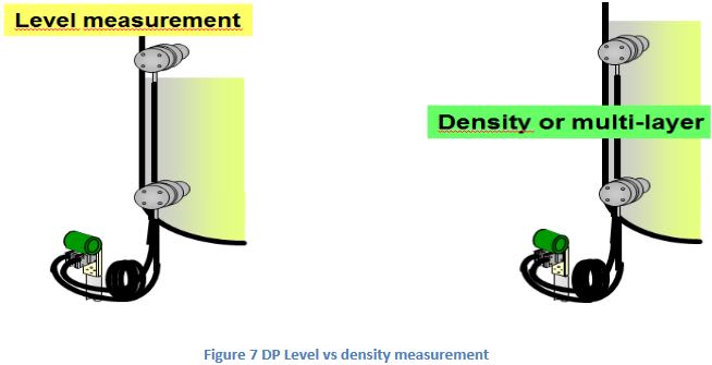

Your diagram, with the liquid level substantially higher than the upper port is typical of a density measurement using differential pressure, as shown the shots below.
There is no way to get a tank level measurement when the liquid level is above the upper sensing port; the transmitter will report its maximum 20mA value.
Is your question about calculating volume academic for a true level measurement or are you trying to calculate volume based on a density measurement?

What I am doing at the moment is to determine what is the liquid volume left in the vessel if the level in the vessels reached LL and on this LL in millimeter (mm) what percentage of the level would be?
