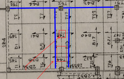

Hi Structural Engineers:
First of all thanks to all engineers who are helping hospitals/clinics/urgent care for analysis and upgrades to help covid patients accomodation.
I have a two-way flat slab supported by concrete columns and perimeter beams.
The contractor made openings in the column strip along the end bay. Initially, it was shown there by the MEP engineers but a later structural consultation revision was sent to make an opening at a different location in the middle of the slab. but accidentally they made an opening in the first location.
Does anyone know any way how to analyze and support and transfer the loads to the adjacent slab in case of opening in column strip? i could not find any documentation for openings in column strip and how to distribute in a manual calculation. see attached existing plan with opening.
My thought process is to model it in software, find moments around opening and provide respective steel below and extend to adjacent rebar based on their capacity. I may be wrong but need some expert suggestions.
ANy help is appreciated.
 https://files.engineering.com/getfile.aspx?folder=75f66a48-7ffc-4917-9da9-213641ea2ce6&file=Two_way_slab_opening-_error.pdf
Has it already been poured? That would change a lot of the thought process. If not, why not move them appropriately?
its an existing slab. They already cut it. But for other locations, they are following my suggestion to keep it in the middle of the slab bay in two directions.
Those are pretty substantial sized openings, I highly doubt you'd be able to load share over to the middle strips, and then back to the columns appropriately. I'd be putting steel beams picking up everything.
ok thanks that's what I was scared about. i may have to do a a drill and epoxy headed anchors to engage the slab to the beam. or and edge angle around teh opening and weld to steel beam like you suggested.
thanks for your time and suggestion
I don't think that would be necessary. I'd be having them grout pack between the slab and the new steel beams. The most critical connection I could see would be the steel beams to those edge beams.
The second pic is scarier than the first. It shows the rectangular opening rotated so that it takes a 42" chunk out of the column strip very close to the column. If these are field cut openings in an existing slab and if your second pic is close to scale, you will likely need to provide steel beams under the slab, one each side of the openings to prevent a punching shear failure.

I was a bit slow, so I didn't see the suggestion by jayrod12. I would hope to avoid the beams running east-west by hanging the north-south beams through the slab.
BA
I would too, but I have my doubts that those column strips there can now take the point loads from the beams. Potentially they can, but only the OP can figure that out once he figures out the loads accurately.
Demo the concrete and restore the slab with some strengthening, if necessary.
Yes, that is an expensive mistake to correct.
thanks all for your suggestions. I will do my finite element analysis verify the moments around opening and provide steel beams or Carbon fiber reinfrocement adjacent to opening.
Will keep you all posted. Thanks
BA,
The large opening is right on two orthogonal column strips, punching shear... too many complications.
Yes, complications for sure. I wonder if the contractor took care when cutting the holes not to run past the opening dimensions. There is already a stress riser at the 90o corner but over cutting would make a bad condition worse.
BA
You are absolutely correct. I think they need to shore the entire work area, or even jack up a little to release the built-in stresses.

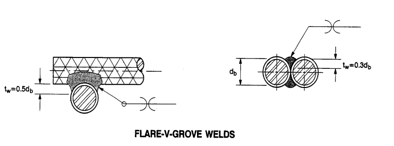

May be I was a bit late...
I will suggest repair of the rebars with welding and the steps for repairment,
i) Make accessible the existing rebars with chipping the concrete,
ii) Temporary support the column strip with props and apply jacking,
iii)Add new rebars with welding to the existing ones,
iv) Formwork for the holes,
v) Apply epoxy to the surfaces and pour new concrete,
vi) Remove props after conc. gain strength and test the slab with loading.
Good procedure. May use mechanical coupler too.
HTURKAK,
Sounds like an excellent idea.
The first sketch shows orthogonal bars being welded together, but that is something that would not be done in a normal installation. Normally, bars would be tied together with wire to keep them in place while pouring, so I am wondering if that type of weld is necessary.
The second sketch shows bars welded to restore their axial strength. The splice bar is eccentric to the existing. A mechanical coupler was suggested by retired13. Alternatively, two bars could be used, one on each side of the existing to avoid the eccentricity. It's a small area, so the amount of material is not too significant.
