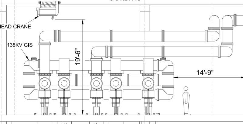

Hello,

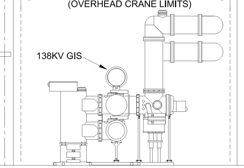

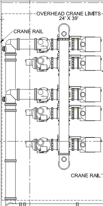

First post here. I've seen a project where the design has planned 138kV GIS in a ring bus arrangment, however, I'm having a difficult time visualizing how this gear is actually configured based on the preliminary public domain drawings. I believe this is ABB's GIS switchgear, however, I have seen it in a different configuration where the cable termination sides alternate between the upper and lower bus positions - I've never seen one configured with all cable terminations in the center position. Possibly someone has a better view of this type of bus configuration? It is a ring bus configuration as I understand.
See pics below for reference.
Cable Side Elevation View
Side of the Lineup
Plan View (Top)
Thanks!
It appears that this gear is arranged with 5 breakers in a ring bus configuration with feeder cables and two SF6 busses (trafficators). The sketch below is a 6 breakers ring bus with fed with cables only.
I hope this help to clarify how a ring bus is arranged in a GIS.
Coupe of other questions - when you say "trafficator" are you talking about the (2) buses which leave the gear? Those are actually feeder busways to transformers. Also, as I understand this particular project intercepted existing HPFF cables and routed them in and out of the substation (basically extend the existing circuit in and out of the GIS gear). Can HPFF cables terminate directly to GIS gear, or do they need to transition splice to XLPE before they connect to the gear?

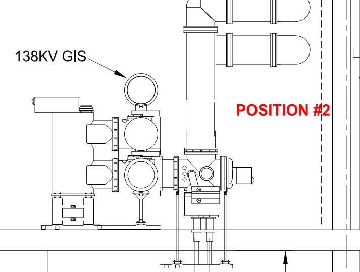

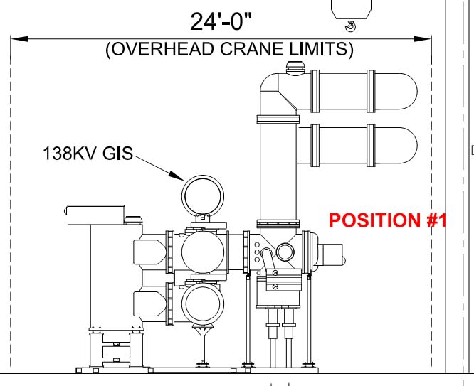

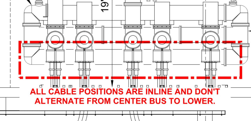

Also, something else I noticed, the design I'm referencing has the cable positions all in the center, whereas the typical you show shows the cables alternating between the lower and middle bus. Basically your example would look like this:
Position #1
Position #2
Instead of the way the bays are arranged, in the typical view, the cable exits are all in-line and don't alternate upper to lower.
So not entirely sure how the buswork would need to be to make it like that. Perhaps this was an early mock-up drawing that isn't quite correct in terms of the actual manufactured layout of the gear and how it would be done.

...in the typical view, the cable exits are all in-line and don't alternate upper to lower]
To meet the client complicate clearance requirement, the cable termination was alternated to achieve the required cable termination distances without changing the pre-defined GIS cable module. [sub]I do no know good technical reasons to justify the additional complications.[/sub]
SUGGESTIONS: Ask the GIS manufacturer to furnish a cable holding hardware bolted to the bottom of the cable module to limit the cable SC forces. Also, the cable should be adequately routed to avoid safety exit constraints in the cable vault below the GIS with enough height for appropriate bending ratio and holding cable clips.

For the 138 kV application, there are two types of GIS design available into two main categories:
a) Type 1: a non-segregated bus with the breaker in a single tank. The majority design rated up to 170 kV, with some exception rated up to 230 kV. Up to know, this is the most cost-effective option available in the market.
b) Type 2: Segregated /Isolated phase design, which 3 breakers tanks. This is a compact design rated for 145 kV show in the market around the year 2000 as an option with reducing weight and SF6 gas volume up to 40%.
