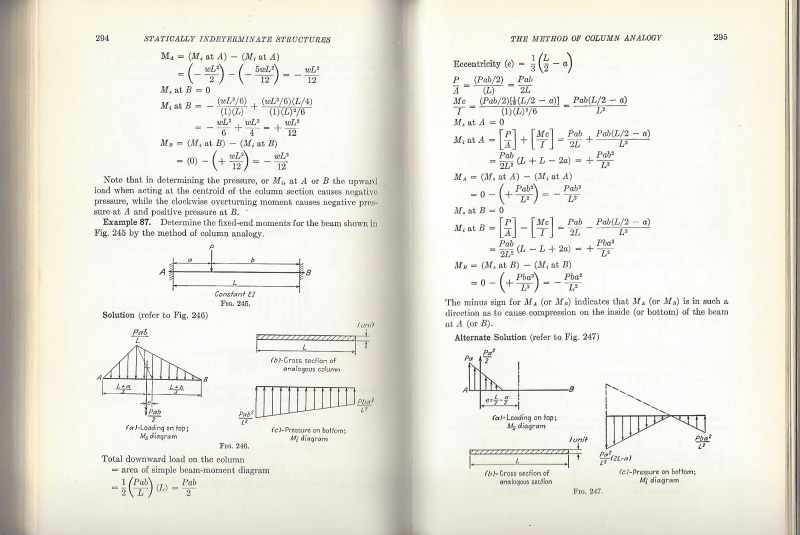

You may find it easier to see, using the method of Column Analogy which is explained in the text and diagrams below:
BA

BA's method will help to strengthen your understanding of the classic method. My approach will save time.

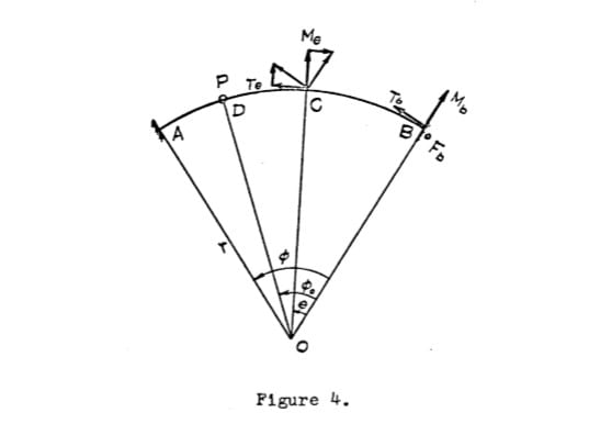

Thanks for all of your replies. I was able to find the support reactions easily by applying Castigliano's theorem. and then as rb1957 said integrating starting from v(x) solves the problem. But the main problem I was trying to solve was the deflection of fix-fix CURVED beam, which I'm not sure that integrating from v(x)is correct. The moment area method can be applied as shown in the attached figure. but here ∅/2 means the centroid has to be at the mid span right? or Am I correct that it is actually the distance to the centroid? If so, to find the deflection for a system with a load at random location I just have to replace the ∅/2 with correct radial distance to centroid right?
 https://files.engineering.com/getfile.aspx?folder=0bce0771-b17b-4623-8f30-71b87f01d2ec&file=deflectionCurvedBeam.jpg
Below I attached the arrangement of the beam.

horizontally curved beam : and the load in plane of curvature or perpendicular to plane of curvature ?
Perpendicular to the plane of curvature so there will be torsion.

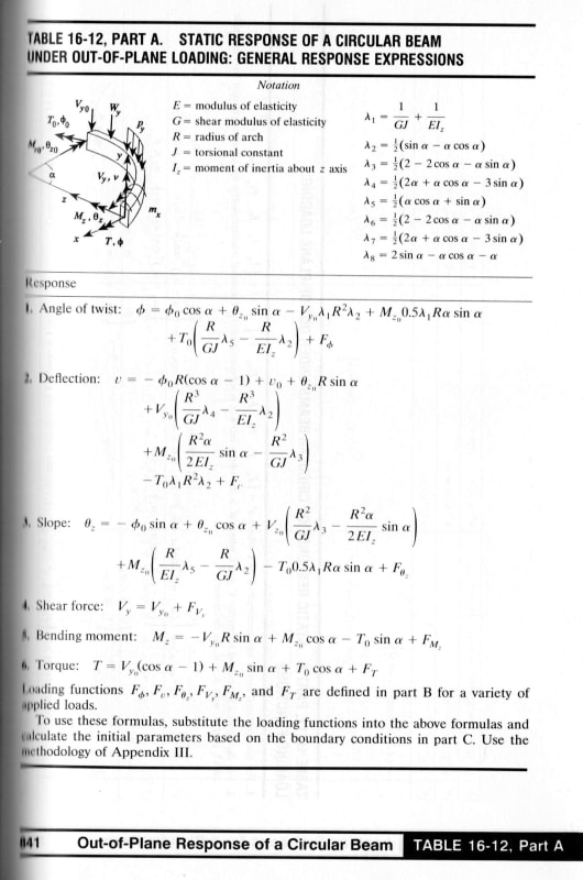

theory : Roark's formulas for stress and strain - 7th edition - sec. 9.5 Curved beams loaded normal to plane of curvature and sec. 9.6 tables
"Formulas for stress, strain, and structural matrices" - Walter Pilkey

@rb1957 No I initially wanted to study the derivation of fixed straight beam and then moved on to curved beams. In the book that roby suggested has everything I need. But seems like there's no derivation in it so I can study it. I will use FEA (abaqus) later but for now I just need to study it in a theoretical level.
@agent666 I solved it using superposition. Don't know if it is correct but I can verify it using expressions that roby suggested.
