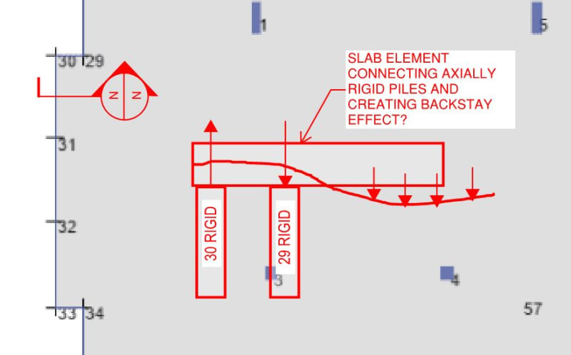

I don't understand this. So you are saying that the internal slab is being cantilevered by these two piers and thus making the loads on external piers to be uplift? What if I treat them as one support like normal as what I simplified? what will happen? This is killing my monkey brain now as the detention has been constructed.
Sounds like you understand the concept perfectly. Only you can determine if the concept truly reflects what's going on in your model though. How thick is your slab? Can you output local moments and shears in that area? Are your piles modelled as axial springs or rigid supports?

If my diagnosis checks out then my prognosis is that this will be just fine. Real world flexibility in your pile, slab, and the connections between the two will likely steer the loads towards those of your simplified model.
I'm not sure that I actually understand your situation. Can you sketch the section that I cut above?

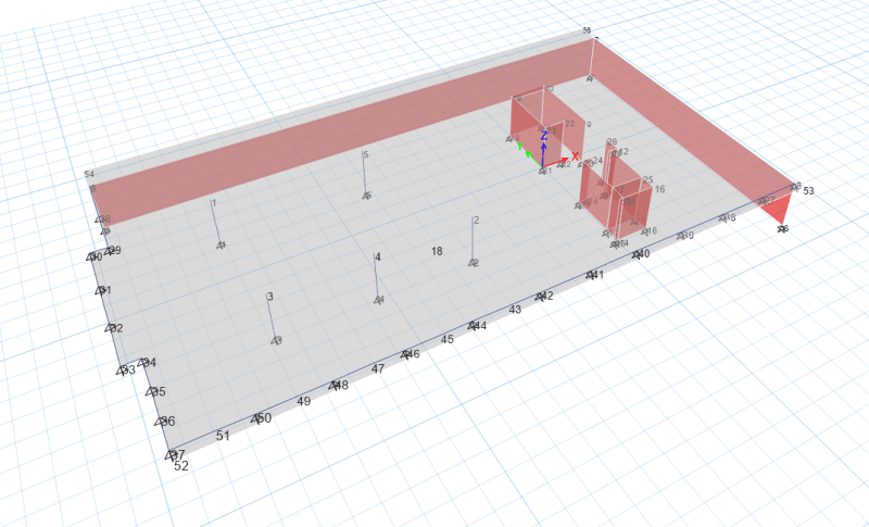

Below is the 3D view. (I have also uploaded the Etabs model above). What happened was the architect make the RHS basement walls offset a bit and back then I didn't think that was a major change so did not bother re-calculate on this until yesterday.
It is just flat slab sitting on top of capping beams, which supported by bored piers. All these lines in the pics denote capping beams (530x600(D)).

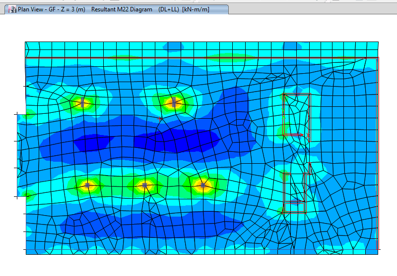

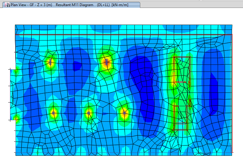

Slab is 400mm thick. I simply modelled them as rigid supports. Please find below M11 & M22 contours.
But... I don't get why the internal slab will be cantilevered considering there are internal supports?
400mm thick slab, rigid supports... That creates an extremely stiff connection. Hence you get the behavior as exhibited. Naturally two rigid supports with a rigid slab will behave very stiffly compared to you other boundary conditions. Thus attracting more load.

I understand it will create a more stiff support with two close rigid restraint but what causes the uplift? I didn't expect one will be in tension and the compression in another one will increase so much though. However, this is what the actual layout is like. So which model should be adapted? The original one or the simplified straight line one? I have designed as the later one and am concerned as the results differ so much...
Kootk has already covered that. You have moment reversal. Or or more laymans terms a fulcrum effect on support 34 creating an uplift on 33. Think of it as a simple beam with 3 supports.

Yeah you are right. Didn't think of that. I misunderstood what KootK said as cantilever behavior.
So what happens if I had already designed them as straight lines. (KootK reckon it should be fine but I still cannot fully understand the mechanism when it was designed as simplified straight lines and then point 34 'fails'.) there are two more stories and this 'back-span' effect will be more obvious apparently and the reaction at point 34 will definitely beyond the design value I had using simplified method.
So below is my assumption: say point 34 fails in compression or deflects more (spring support?), and loads will distribute to point 33 more, which is close to my simplified straight line model? so it should be fine? What about the capping beams? if point 29/34 fails then the capping beam there will be cantilever?
