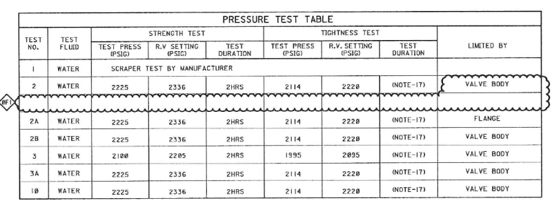

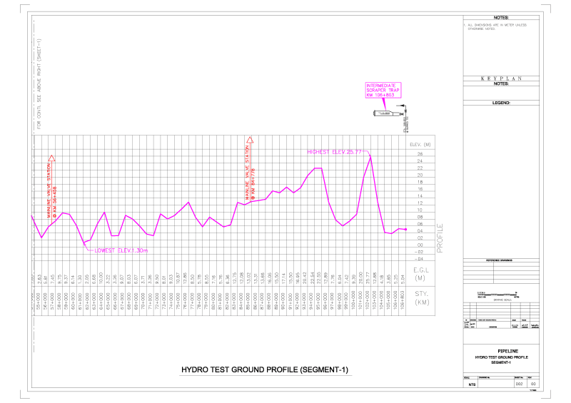

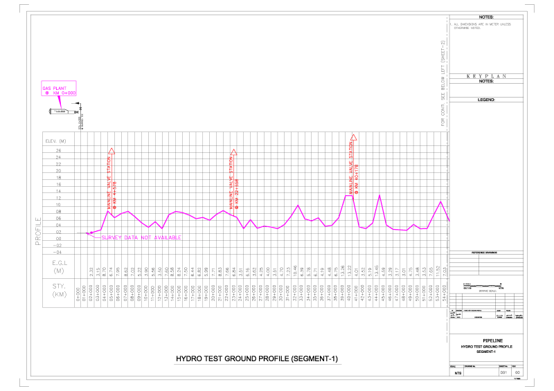

Jun 21, 2020 Thread starter #3 xnabrar Mechanical Feb 1, 2016 28 0 0 SA Dear, Attached herewith are the relevant drawings/documents for the pipeline. We request for the pressure drop calculation for the highest point, lowest point, and at the Test Manifold point (KM 106+803) in the attached pipeline Profile survey report. Hope you understand the problem. Upvote 0 Downvote
Jun 21, 2020 #4 LittleInch Petroleum Mar 27, 2013 21,103 3 38 GB xnabra, This is about as basic as you can get.... pressure in bar = m x SG x g / 100 or m x SG / 10.19 Your highest point seems to be 25.8m, lowest 1.35, trap elevation 5m. I think you can do the maths from here on.... Remember - More details = better answers Also: If you get a response it's polite to respond to it. Upvote 0 Downvote
Jun 21, 2020 Thread starter #5 xnabrar Mechanical Feb 1, 2016 28 0 0 SA please clear me for the equation. pressure at highest point = (5.8 x 5)/10.19 = 12.65 PSIG pressure at low point = (1.35 x 5)/10.19 = 0.6224 PSIG please explain about SG. thanks. Upvote 0 Downvote

Jun 22, 2020 #8 LittleInch Petroleum Mar 27, 2013 21,103 3 38 GB Your answers are not correct. Remember - More details = better answers Also: If you get a response it's polite to respond to it. Upvote 0 Downvote

Jun 22, 2020 #9 hacksaw Mechanical Dec 7, 2002 2,558 0 36 US Don't forget acceleration gravity, g, and check your units Upvote 0 Downvote
