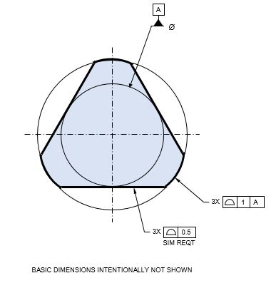

How about something like this?

Not in the example I gave, but if B was a feature of size, then it would invoke a MME, wouldn't it?

I think we could do something like what you're showing. I see that as sort of equivalent to using a note that would say something like "USE THE UNRELATED ACTUAL MINIMUM MATERIAL ENVELOPE TO ESTABLISH DATUM A".

Doesn't the 0.5 profile tolerance on the form, mutual location and orientation of the three flats allow them to be either 0.25 inside the diameter of datum feature A, 0.25 outside of it, or anywhere in between? If yes, how is A a minimum material envelope?

I think I see where your question is coming from. Other than mentioned in 4.5.1(d), there is really no such thing as "Minimum material envelope" in Y14.5-2009, therefore I took it as "Actual minimum material envelope", which is in line with what 4.5.1(d) evolved into in corresponding para. 7.5.1 in 2018:

I too understand the 4.5.1(d) "minimum material envelope" to mean either unrelated or related minimum material envelope. The lack of "unrelated"/"related" in the wording is not what triggered my question. It is more about how such datum feature simulator/true geometric counterpart should be invoked in the drawing.
As for your example, I think I see how this suggests the minimum material envelope as a datum feature simulator, but I have two questions regarding it:
First, how do we know that the inscribed theoretical cylinder is just inscribed in the actual feature and not part of the basic geometry definition (I.e. fixed in size and not necessarily tangent to the flats on the low points). In cases such as fig. 4-35 in the 2009 standard I would expect the three pins pattern to be fully defined with basic dimensions and position tolerance, then the circumcircle with no diameter value is clearly adjustable at size to contact the surface of the as-produced pins. With the profile application as shown in your example - I'm not sure the same interpretation is expected.
Secondly, why is this cylinder the actual minimum material envelope rather than three theoretical planes that contact the low points on the flats?
I am not sure why the same interpretation could not be expected here. The dimension for the diameter of the circle/cylinder has no value, just like in fig. 4-35/2009. The profile tolerance for the flats controls relationship between them just like position tolerance would control relationship between the three pins. Additionally, the cylinder A cannot be considered fixed in size because it has been referenced RMB in the profile callout, not LMB or BSC.
They (the three planes) could be, but because I specifically made the cylinder the considered feature, the actual minimum material envelope is cylindrical. Again, the logic is similar to what we see in fig. 4-35.
pmarc, thank you for clarifying. I now clearly see the similarity to the concept shown in fig. 4-35 (only with the relevant envelope being "inside the material") and I agree that this is a possible case of what should be interpreted as a minimum material envelope datum feature simulator.

I believe that the examples shown in Fig 4-35 of Y14.5-2009 and pmarc's example above all depict mating envelopes instead of minimum material envelopes. To make any of these into examples of using the "actual minimum material envelope" to establish a datum, I think a note is needed to explicitly state the the envelope must be fit to the low points.
What am I missing?
Another point that I think would be interesting to talk about is why "SIM REQT" is added to the profile applied to the 3 planar surfaces in pmarc's example. If we don't need that note when profile is controlling coplanarity or "co-stepularity", then why do we need it in this case? Yes, I'm picking on the lack of sufficient grouping rules that we all know are on their way to be improved, but I would like to learn what difference you see as making SIM REQT necessary here. Just the lack of an example figure in Y14.5 for this particular application? What if I said that SIM REQT is never needed for profile, since the concept is that it controls coplanarity and stepped parallel planar surfaces without this note, so it will control the relationship between the features that are not parallel without the note as well? What about profile all around, which I believe is controlling all features connected and seen edge-on in the particular view and the relationship between them, with no SIM REQT added?

Dean,
You are right that a note would make it explicit and that SIM REQT is not really needed. It still doesn't change the fact that there is a way "to specify an unrelated actual minimum material envelope as a TGC".

I didn't understand pmarc's figure at first either. But now I see that the inscribed cylinder representing the irregular FOS for datum feature A is inside the material. This is different than any of the examples in Fig. 4-35, which are all outside the material.
Regarding the SIM REQTS annotation, I'm not sure about that either. The 3X would act as a grouping mechanism.

What tells us whether that circle is fit as "mating" or "minimum material" in the only 3 places it interacts with the feature? I still think a note is needed to overrule the default (an the only supported) Y14.5 method of fitting to the high points of the feature.

If the method is to add a note, is that really supported by Y14.5, or instead requiring a note, because it is not supported by Y14.5? I think it would be good to add an explicit method that invokes the actual minimum material envelope as a TGC when that is needed.

I did not say the method was to add a note. I said that addition of a note would help to clarify the intent. I still think that the circle on my drawing illustrates UAMME.
