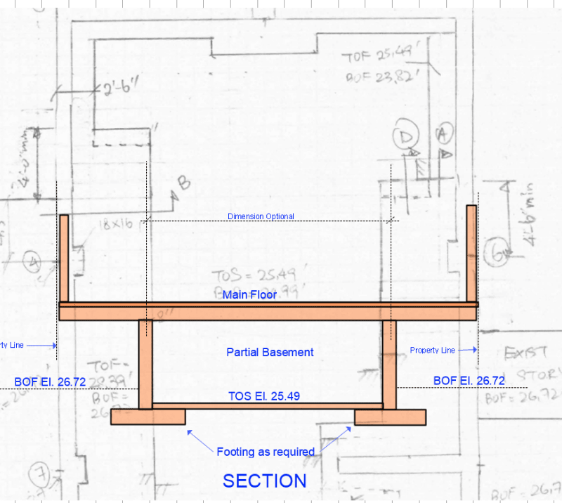

How will the Main Floor be framed? It could have a bearing on the design of the foundations.

You show pilasters or columns every so often in the side walls. Play with tighter spacing of these and then put tie beams across the bldg. and btwn. the two columns across from each other. These tie beams are down below the finished slab but tied into it so the entire bsmt. slab acts like something of a waffle mat in taking the eccentric loading from the side walls. The side walls should also be treated at deep beams spanning btwn. the tie beam systems. This is a complicated enough found. situation that I would want a GeoTech guy/gal helping me. I wouldn’t trust just kickin a little dirt to determine soil properties, and determining what I’m going to do. I would narrow your eccentric wall ftg., with its bot. elev. matching the existing ftgs., but then dig at each tie beam as close to the existing as possible, for a short construction duration, so I can tie the col., eccentric wall ftg. and tie beam all together. The mat then acts like a beam on an elastic foundation with two large line loads at its extreme ends.

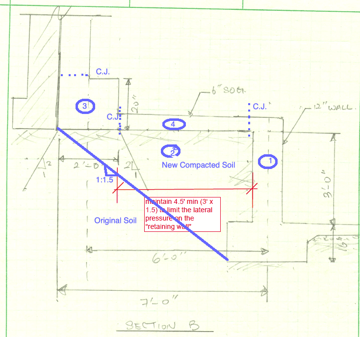

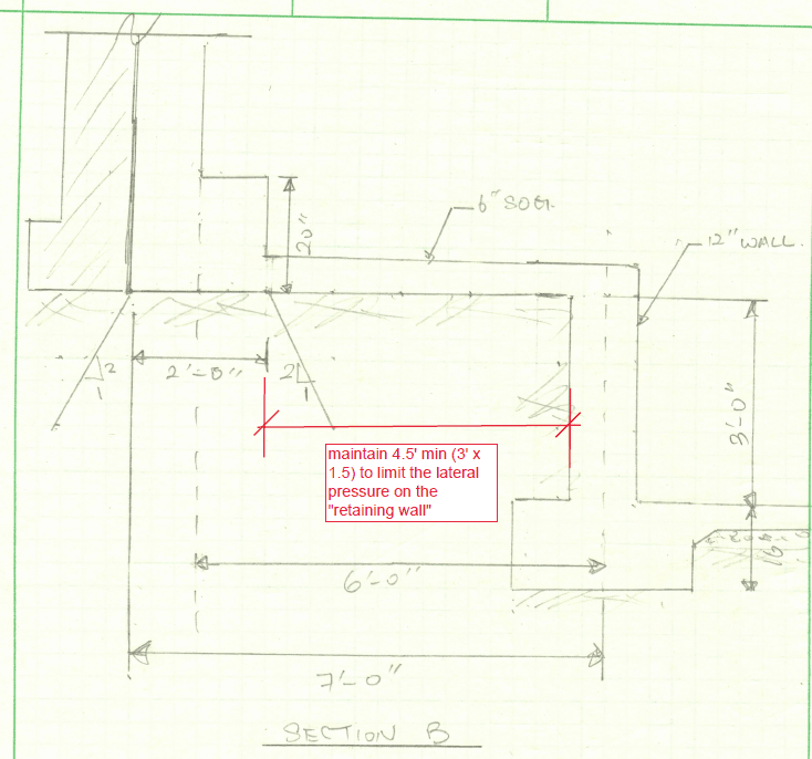

I revisited this idea and came up with the following detail.
This seems more feasible and avoids the slope footing at some of the column/foundation wall locations, although not at the shearwall locations.
My questions is....what is the ideal distance between the "upper footing" and the "retaining wall footing" so that the lower footing would not undermine the "upper footing" and also limit the amount of lateral stress on the "retaining wall". My rule of thumb is 1.5 x the change in elevation. In this case, the minimum distance beween the footings is 1.5 x 3' = 4.5' min.
TimeToPlay,
I think going back to installing 5-ft deep underpinning piers is the way to go. You have a four story load bearing on soil that is also supporting the two-sty existing building. The new 4 story load and cellar wall load will most likely cause settlement damage to the existing adjacent foundation that you will be responsible for and should avoid. Excavating to the bottom of footing alone may cause settlement because you are removing the soil overburden. ( A geotechnical can help on evaluating this condition since we don't know the soil parameters.)
Your new sketch does not show the sequence of concrete pours which must be indicated on the drawings. If you do install the retaining wall first (as a better installation sequence) your soil berm slope is 4.33V:6.00H approximately 1:1.5 to temporarily resist lateral soil movement below the two story structure but may not be adequate enough to prevent lateral movement of the existing structure. Check with your geotechnical on whether soil can be cut on the steep 2v:1h slope that you show.
TimeToPlay,
Your latest sketch shows a dimension of 3'-0" between bottom of existing footing and top of new slab. Initially, you show BOF 26.72 and TOS 25.49, a difference of only 1.23' (say 1'-3"). Was I misinterpreting your elevations?
If a specified headroom is required in the basement, then the depth of Main Floor beams may have to be limited, so perhaps it is too early to establish the elevation of basement floor.
