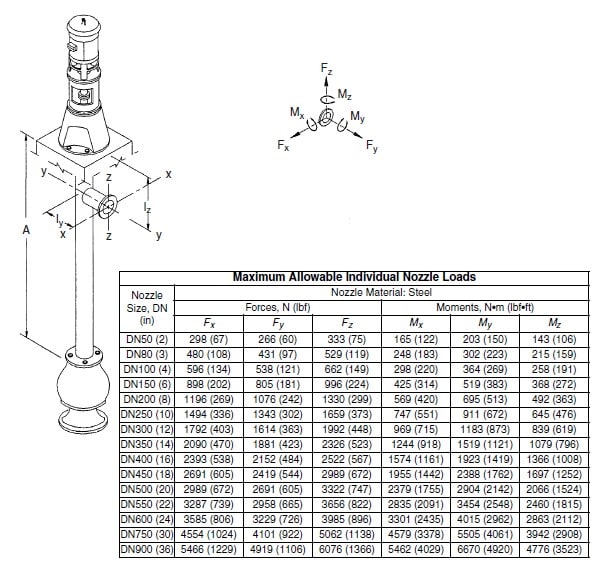

Good morning all,
I have completed the stress analysis on two vertical turbine pumps and have gotten my nozzle loads. The vendor wants to put a brace on the back of the pump that will be connected to a nearby steel beam. I'm trying to work out the correct loads on this brace from the resulting nozzle loads and wanted to see if I was thinking about it correctly. This doesn't really feel right to me, so I was hoping someone might be able to point me in the right direction if this is completely wrong.
Thanks in advance

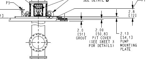

The pump mounting flange is fastened to an approx. 2500 lb pit cover as shown below.
The pit cover itself is resting on concrete that is part of a raw water intake structure extending out into the river.

With the below grade vertical discharge pumps, the allowable nozzles loads are very low due to the geometry of the pump and the distance of the nozzle from the mounting flange with an additional "unity" requirement.
We have an asymmetrical layout, 30" STD pipe with 40 degree temp. variation, expansion joints, and it's an existing structure where I could not be provided accurate stiffness values during my pipe stress. I imagine my forces are conservative, but I couldn't justify reducing the support stiffness values any lower than where I had them. That's all to say that we're reporting sizeable forces and moments on a pump that has low allowables.
We requested API Double Load Nozzles, and they have beefed up the pumps, part of which includes these braces. The existing pumps have similar braces in the same location as well for what it's worth when they did the design 40 years ago.

What the nozzle loads from your analysis and how do they compare with the allowable?

The 2500 lb, 2 " thick pit cover covering a (scaled) 3.5 foot opening looks more like a trampoline or cookie sheet to me.

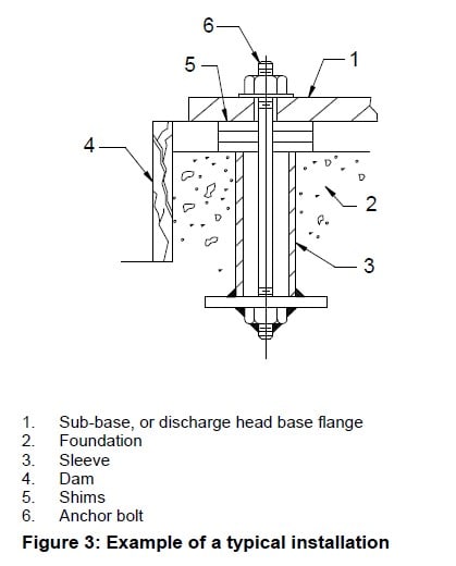

In my opinion the grouting and anchor bolt shimming and base leveling as-built details may very possibly NOT be what is shown on the drawing,
And by themselves cause excessive vibration that can start an expensive and adversarial side trip for the project.

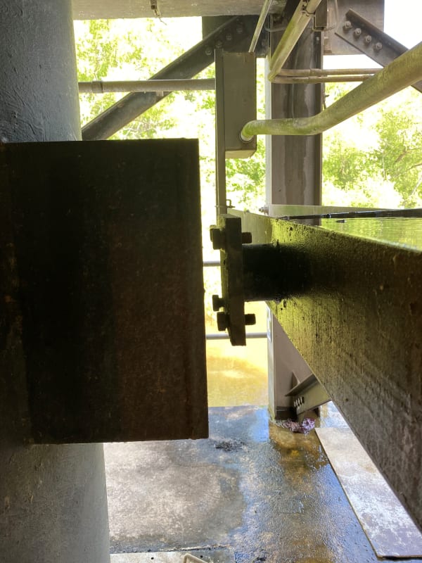

Finally, the existing pumps have a gap between the brace and the supporting steel as shown below.
I am no expert in this field, have only been a full-time engineer for a little over a year, but I would think this confirms the thinking that if the new brace is the same type as the one shown below that it is for dynamic/vibratory issues and not for any static load. There is an expansion joint at the discharge nozzle as well, could it be some type of safeguard if the tie rods fail and the expansion joint tries to expand from the internal pressure?
I would love to be able to perform a dynamic analysis on this system but it's not within the scope of the project, nor does our office/myself have the technical know-how to perform this type of analysis. Just doing the static analysis and trying to explain how the support stiffness needs to be within a least an order of magnitude for an accurate solution was hard enough. Trying to correctly model the boundary conditions/boundary stiffness's is certainly not within our capacity at the moment.
I couldn't find any information in the pump IOM or online about this type of brace, so I second all those above who asked if anyone else has more information about this design element I would be very interested in learning more about it.

The typical installation shown below for mounting on concrete does show shims, but we haven't gotten the specifics from the manufacturer. I will update when/if we get more information.
A brace with a gap seems non-sensical to me.
It looks like there was an option to bolt an intermediate piece that wasn't used.
A brace with a gap would not affect the dynamic characteristics except for very large movement which seems unlikely... leads to your next point...
The bolts argue against that. What purpose do they serve? None unless to bolt an intermediate part which is not present. Further, if this bracket was used as a backup for this catastrophic failure that you describe, then those bolts should be removed because the bolt heads are going to concentrate the force over a smaller area, right? I wouldn't think the bolt heads would be sticking out like that if the support was intended to carry load in this backup scenario.
EDIT - Whoops, the scenario I didn't consider about those bolts is maybe the bolts are gap adjusting devices (in tapped holes). Seems unlikely but you never know. Maybe a look at the hidden (from photo) face adjacent to those bolts would provide a clue about their function.

I too have wondered whether it's possible that it was a provided feature that was never used for the existing pumps. It was installed over forty years ago so information is slim except for some old layout drawings. A brace will need to be utilized on the new pumps though per the manufacturer.
For your comments above, the expansion joint will be included in the new system for vibration damping between the pump and the piping. The size of the expansion joint ("18) with the working pressure (60 psig) of each pump would result in a thrust load of over 10,000 pounds as well, and there was no way we could have a horizontal load that large be supported by the existing structure without serious modifications.
I think you're right that it doesn't make sense for that brace with that gap size to serve as a backup restraint in case of failure from the expansion joint. Just a WAG on my part to try and find a reason for it being there and having some useful function.

I'd ask where this "rigid" foundation is AsSumed to begin for the pump "assembly" design.
- Out at the edges of the 2500 lb, 2 " thick pit cover covering a (scaled) 3.5 foot opening?
- At the pump mounting flange that is bolted to the 2500#2"TPC ?
