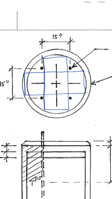

I am designing a circular concrete pile with a steel column sitting on top of it. 1.5" grout was underneath the base plate. circular concrete pile is 36" in diameter. Factored shear is 24 kips. Vertical load is 53 kips. If i will consider friction using coefficient of 0.5, then friction will overcome the actual shear which make it like shear doesn't exist. BUT, i wanted to design the shear reinforcement since my anchor bolt calculation requires it for concrete breakout. And also, giving some benefit of the doubt in case it slips.
I cannot find an exact literature on how to calculate the shear tie capacity for a circular concrete section. So I just attached my calculation and I would appreciate if any of you can comment on it.
Thanks in advance
