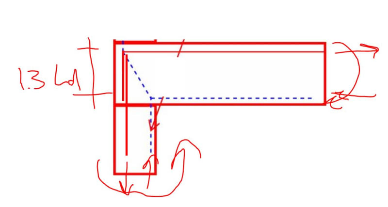

I am using RAM Concrete to design two stories of conventionally reinforced concrete beam and column frames. The beams are 2'-0" deep and range in width from 2'-0" to 3'-10". For the analysis in RAM Concrete, we are considering almost everything fixed at the joints, as this seems most realistic and allowing the columns to take some moment really helps with the beams design and distribution of load. RAM Concrete is showing some pretty significant moment transfer occurring between the beams and the columns, especially at the top floor where there is a lot of load. Can anyone provide some guidance for the primary design and detailing checks that should be done to ensure this transfer can occur at various conditions? I should note that this is a low seismic zone (SDC B) and the beam and columns are not part of the LFRS (we have shear walls for that).
For the beam over column condition at the upper floor, I know I need to hook the column bars and check their development length into the beam. Do column ties need to continue into the beam? Similarly, I assume beam bears need to be hooked and developed at any end joint where a beam terminates?

3) The beam bars do have to be developed within the joint but recognize that, from a theoretical standpoint, development really only gets part of the job done. What you need to do the whole job is:
a) Development and;
b) Anchorage into the joint and the ability to transfer flexural tension from the beam bars around the corner and into the column bars / compression block.The codes, and good designers, generally provide one of two ways:
c) Some kind of lap between the beam bars and the column bars at the the uppermost level of which Lo's solution is one permutation (and a very constructable one) OR;

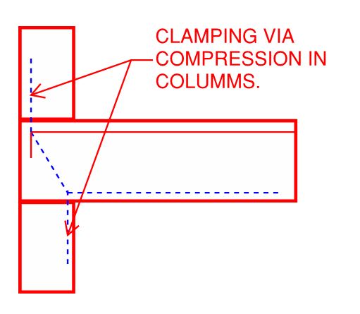

d) Development combined with the handy clamping mechanism available at lower level joints and shown below.
Because the code often lets you make do with clamping + development at the lower levels, I feel that it kind of creates the erroneous impression that development is all that is required.

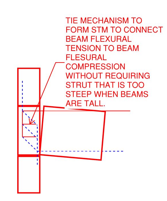

4) There can be a few good reasons to run the column ties through the joints, particularly where general confinement and/or confinement of hooked ends is an issue. I favor typical detailing that shows the ties running through at exterior joints, moment frame joints, and in high seismic scenarios. Where beams are deep relative to the columns coming into a joint, as shown below, the simple mechanics of controlling the diagonal strut angle will produce a need for such ties, irrespective of confinement concerns.

Out of two options(c and d) given by you for clamping mechanism additional to development, option D is only applicable for lower story columns(in multistory construction) and the designer is only left with option C for roof floor columns right?
But I have not seen such detailing in general where I work and they just bend the roof column bars inside beams/slabs for a length of 300mm or so.
How would STM at roof column and slab joint looks like(just without the strut of the upper column?)?
Right.
How would this would work at an interior beam over column joint at the top level? The beam beams would be continuous across the joint and the column bars would extend up to just under the beam top bars with a standard 90 degree hook.
By the book, I believe that it should be something like this if the intent is to share unbalanced moment with the column. That said, I fully acknowledge that the detailing that you've described is the most prevalent in the markets in which I have practiced.
