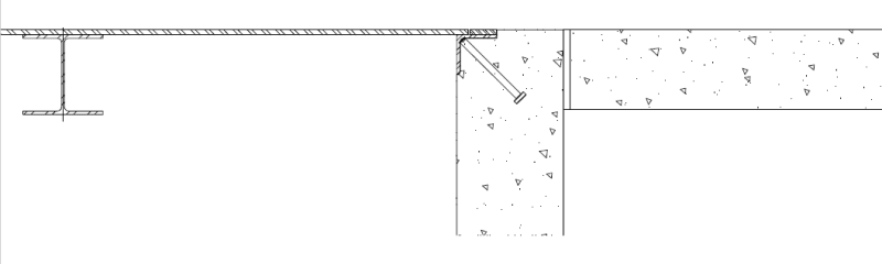

I am designing an electrical trench with floor elevation at -4'-00". This pit has a false floor at elevation 0'-00", for which I have placed beams to pick up electrical equipment and steel plates.Some of the equipment are near the trench wall and hence I need embedded angles in the trench wall to which I am welding another angle that will pick up the equipment along with the floor plates. For the connection of the angle to the embedded angle, what I have thought of is to make slotted holes every 12" along the connecting angle and plug weld it to the embedded angle. I have attached a quick drawing I made to show you guys what I mean.
I have a couple of questions:
1. How do I check the capacity of the embedded angle? Do I check anchorage for this?
2. As the connecting angle (supporting the equipment) is laterally restrained, I can't see it bending. However its toe is in compression so Local leg buckling and leg yielding is possible, right?
Thanks for the help everyone.

The embedded angle has no problem, because it offers no strength. The problem is the headed stud. You shall apply the load to check the concrete breakout strength. If it is possible, you shall provide angle/beam across the trench width with support on the trench wall.
Thanks retired13. I did mean to say anchorage for the headed stud, my bad. When I am checking concrete breakout resistance of the headed stud in tension, do I increase my tension force from the force couple by 1/sin45 to account for the stud being oriented at 45 degrees?

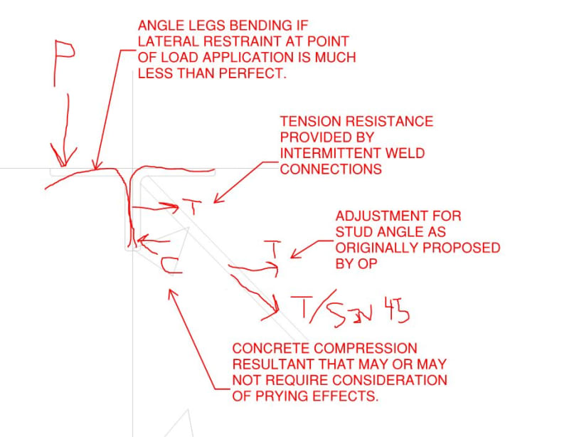

I do see it bending as, in most instances, I would be unwilling to hang my had on the lateral restraint that you mentioned. In order to best help you here, I feel that we'll need to collectively get a handle on what we think the statics of your situation are. Were you to truly have no bending in the angle, you would also probably have no anchorage demand in your studs. Convenient... if it's true.
I don't see locally buckling of the non-embedded angle being an issue unless your weld spacing is so great that you develop appreciable, principal axis flexure in the angle via bending between fastening locations.
In order to best help you, I feel that we should all get a handle on what we think the statics of the situation is here. Is the sketch show below close to how you're envisioning the situation? Full disclosure because the truth is important: I suspect that this is a connection that most engineers just eyeball rather than rigorously design.
Hi Kootk, I completely agree with your markup. That is exactly how I am envisioning the forces.

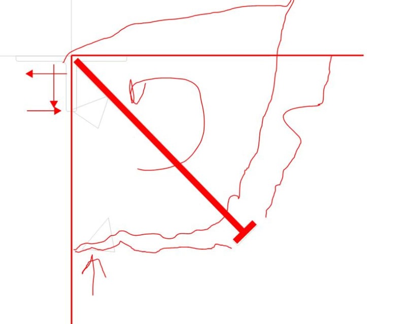

The next trick, I think, is to:
1) Attempt to accurately predict the likely breakout failure mode and;
2) Try to figure out a simple, yet conservative way to cover #1.
The sketch below is my first stab at #1. I see mostly pryout.
Kootk, yes I agree, concrete breakout in tension will govern. That's where I got stuck, I wasn't sure how to resolve the tensile force for the stud to use the Appendix D equations. I do think resolving it to T/sin45 would be conservative.
It sounds as though we disagree as I feel that it's a pryout mechanism that will govern. Granted, the mechanism resisting pryout will be concrete tensile resistance.
Sorry Kootk, I agree with you pryout shall govern. Lot more material to go through for breakout in tension.

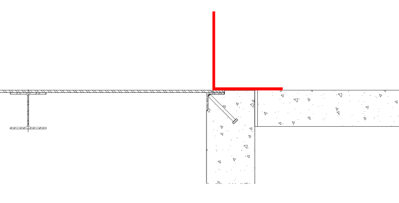

Can you do something like (likely cheaper and easier; it avoids pryout and plug welds in confined space, etc.):
Dik
retired13, could you elaborate on the cross member? I don't think I understand how it may help.
I like Dik's idea and don't understand the objection. It is the way I have always handled this situation.
But if you really need something projecting inside the wall, use Dik's solution with a continuous plate welded to the angle and projecting as far as required.
BA
BART: It's one of my 1000s of standard details... used it for years. Unless there's something about the equipment that relies on the trench being flush... I'd try to work around it... plug welds in the field are a little pricier than welds in a shop... also if the assembly has to be HDG or something. Unless the equipment is continuous, it would be cheaper to notch the plate out for the equipment.
Even a BAR 1/2 x 1 with intermittent fillet welds would be less costly than the field plug welds, I suspect.
