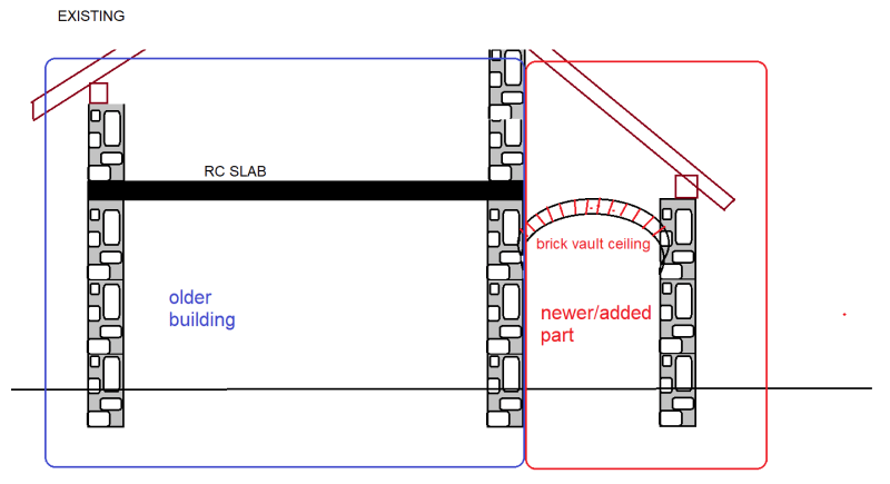

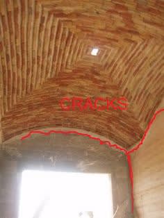

I'm dealing with a very old buidling (stone walls) with RC slab on top. There is a room with brick vault ceiling that was added later (similar to attached photo bellow). There are vertical cracks between old and added part on both sides of the wall(there is no dilatation between). Investor wants to add RC slab on top of existing brick ceiling (there is nothing but self weight on top right now). This will connect both parts and it is a good move in case of seismic forces but I'm wondering about extra weight (concrete on top of brick vault ceiling) since there are already vertical cracks between older and newer part of structure. I think this is due diferental settlements (I have no data about the foundations). Investors said cracks are the same for 50 years now and are not getting larger. What would you suggest in this situation since I have very little data of existing structures? I think there are 2 options - to make aprox. 50 mm thick concrete layer on top of existing brick ceilnig that is connected to existing RC slab (in this case existing ceiling is loaded more) or to make a thicker reinforced slab that will have load bearing function so - I'm wondering how can this be done - How can you support brick ceiling like that before concrete took over?
Sorry for bad language.
Thank you.

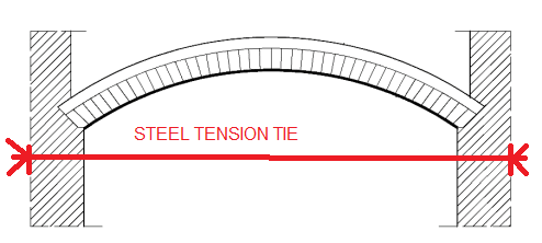

Why concrete? You only need to provide wood/steel ties between the two walls to keep the entire things stable. The cracks looks likely due to shrinkage from moisture changes.

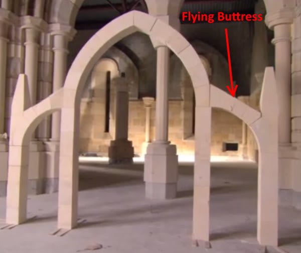

Agree with Ron247, a vaulted roof is just a 3D version of an arch. As load is applied to either of these, the walls supporting a vault/arch tend to "blow out" sideways. That's why medieval cathedral builders had to add "flying buttresses" to resist horizontal load on walls:
Suggest watching this video, or at least the part that begins at 22 minutes: "Building the Great Cathedrals"
The video also shows how historic vaults/arches were shored when they were constructed.

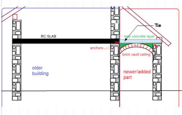

[idea]
This should do. Leave a space between the wood/metal ties and the vault ceiling.

Id like to make RC slab but I dont see how.
Is there a way to support vault ceiling until concrete is hard?
How about adding steel tension tie? Is that doable?
A tie can make up for outward movement due to the thrust but does it change the increased moment on the brick vault?

Did you look at the top of the vault for cracks also?
