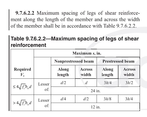

I believe that ACI covers this in the latest edition.

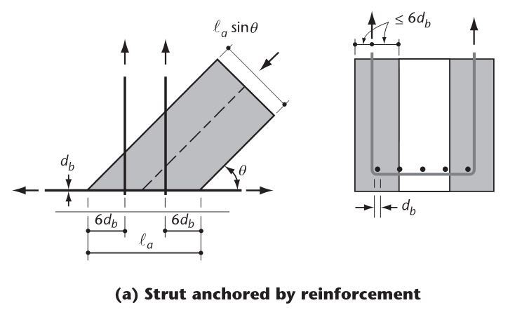

And speaking to Trenno's comments about STM thinking, I've applied the following from Canada's concrete code in the past using similar logic. [12 x db] for high [Vs] situations which seems fairly reasonable to me in practical situations.

Thanks for that screenshot! That is way more stringent than I would have imagined. Basically, if Vs is high enough, you could have a situation where, for example, an 18" wide x 30" deep beam needs an interior tie. That seems a little ridiculous.

I think the logic is that concrete shear capacity Vuc is dependent on aggregate interlock. As the shear crack width increases aggregate interlock reduces so shear capacity reduces. The spacing of the legs needs to be restricted to reduce the shear crack width and that is more critical as the shear stress carried by the stirrups increases.
Thats very relative though to your perspective, for parts of the rest of the world (you know outside of America), certain countries have had this in their codes for literally decades. Why? Because it is fundamentally required to address how shear works in the real world vs simplified code equations for the reason(s) Rapt notes.
Suddenly because ACI have finally had it codified in a similar manner and you chaps have been effectively getting away with not doing it previously, what is probably considered "standard international best practice" gets called out as being ridiculous.
To add to what Rapt notes, it is also I believe about keeping the horizontal forces developed in the cross section in check as well by limiting the strut angles to the vertical if you consider limiting cracking longitudinally along the beam if you get larger horizontal components to the vertical shear as it resolves itself to the vertical stirrup locations across the width of the cross section. The wider spaced your verticals are across the width of the section, then the higher these horizontal stresses are.
