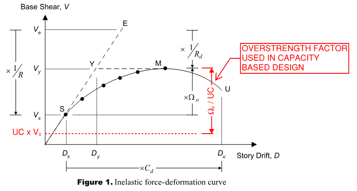

I think it's great that you're thinking about this and would encourage anyone engaged in seismic design to do the same. The graph below taken from one of the Blue Book articles I referenced above illustrates this well. The ASCE 7 R factor is the product of the system ductility factor Rd and the system overstrength factor Ω0. For simplicity, let's assume that the ductility factor is constant and depends solely on the detailing and ductility capacity of the lateral system chosen.
As you noted, if the lateral system is significantly overdesigned, any brittle elements in the load path that are designed using a prescriptive overstrength factor may fail prior to allowing the lateral system to reach full yield at a load of Vy. So if you are truly concerned about trying to keep these brittle elements from failing prematurely, I would encourage a capacity based approach which would account for the overdesign in your lateral system.
