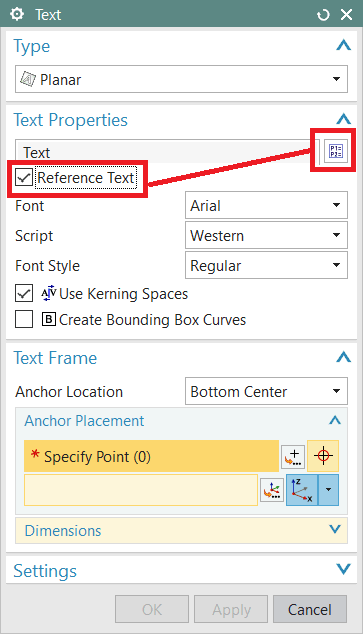

I'm using NX12. I would like to know it it posible to link an engraving text to the part name through atributes, etc. I attached an JPG file as an example: Part name: 26231-3.prt, then I want the engraving the same reference. It's posible do it automatically? In thi way I want to avoid posible mistakes.
In my template I have the following attibute for part name: <W@$SH_PART_NAME>

The "ug_AskCurrentWorkPart" function will pull the part name into a text expression. If you search this forum, there are several examples. Once you have this text expression, you can reference it in the text command. Note that if/when the part name changes, it will require an "update for external change" to update the expression value.

I do not see how it is possible to link the text curves to an expression

When you turn on the "reference text" option, the expression button becomes active; when you press the expression button, you can select an existing string expression (or create a new one) to reference.
When using the text curves as the basis for a feature (such as an extrude), use the "feature curves" selection intent option - this way as the text changes, the input curves will update automatically.
