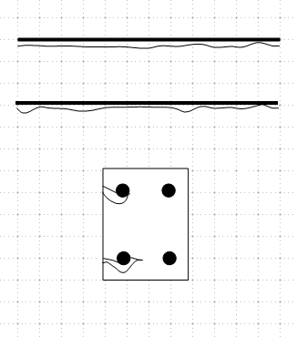

Why am I seeing horizontal cracks in the precast lintel?

I believe it is drying/plastic shrinkage along the exterior longitudinal bars (acting as restrains), formed in the early stage; also the lack of stirrups to confine its grew in size.
Retred13 probably is right. Likely the concrete used for the lintel was soupy liquid, lots of water in it. In addition to the cracks, the concrete likely is very weak. However the arching action of bricks will save the day for the increased height. I'd not worry about the crummy lintel.

Gotta disagree on the lintel. Those cracks are in the wrong direction for shrinkage cracks. Older lintels were often made with rebar on top and bottom because they actually had no top or bottom so they could be installed either way. I would bet on water intrusion causing exfoliation of the rebar and thus, expansion of the rebar and cracking of the concrete. The crack follows a natural line consistent with rebar placement.

The reason I was reluctant to call it a weathering crack is due to the lack of rust stain, which is usually associated with cracks caused by water and moisture. The crack due to poor concrete quality should look like the sketch below on both faces of the lintel.
After adds on, the wall needs to be checked for the lateral load effects according to design code. I am not sure the channels would work on one side only. You need to throw some numbers to figure it out.
Sketch.
Lintel cracking sure looks like the result rebar corrosion and swelling. I've seem plenty of that and rust stains are not commonly evident.

Cracks due to rust of steel will likely to have other indications - usually on exterior exposed, or surface subjects to constant/cyclic intrusion of moisture; and uneven surface due to the push out by volume expansion of the rust.
Retired, I have inspected hundreds of cracked/spalled/delaminated concrete and apparent rusting on the surface of the concrete is actually a rarity.
I too would expect plastic shrinkage cracking to be vertical. I'm not entirely convinced that it is due to corroding steel but it does seem the likely culprit. There is a very simple way to check this. Take a standard framing hammer and "hammer sound" the surface of the concrete all over. The concrete should make a "Tinging" sound when you strike it. If it makes a hollow "Tong" sound when you strike it, it means that the concrete has delaminated from the rebar probably due to corrosion.
Yes. Rust expansion causes separation and lose bond. The plastic/drying occurs right after concrete has started to set, usually form pocket directly under the rebars. It should appear on both faces of the beam.
