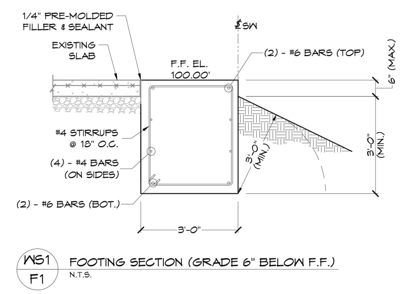

I have a footing where there will be a descending slope adjacent to my grade beam. The grade will never fall below the bottom of the footing but I want to make sure they grade around the footing properly to protect from frost. Here is the detail I am planning on showing. Is there a better way to show this? I have not designed the footing yet so you can ignore all the other information at this point.
Welcome your thoughts. Thanks.
If the frost depth 3' , you may consider the blinding layer also. However, IMO ,the picture is conservatively O.K.
you need to indicate how far away from the footing to take this. up to 3 feet away from the footing? what if the slope extends for 20 feet away from the footing, are you still requiring the 3 feet dimension?

Thanks for all the input. Yes, the frost depth is 3'-0".
cvg, do you think this is more clear?
well, i doubt that the slope will ever be vertical, so no that is not any better. i think a horizontal dimension would be more clear
For right triangle, the hypotenuse and the leg can't be both 3'. You should eliminate one. I suggest to increase and keep the vertical distance, so the 3' requirement is met when measured normal to the slope. Practically speaking, I'll keep a flat bench next to the grade beam, for easy/better compaction and retention of the soil.
The criteria should probably be that you want 3'-0" minimum from the bottom of the footing to the grade. If so, the first detail was the best. If there is any doubt, you can always add a bit of insulation.

I don't know how much of a bench could be located. There is a parking lot about 8' away from the edge of the footing and 42" below finish floor.

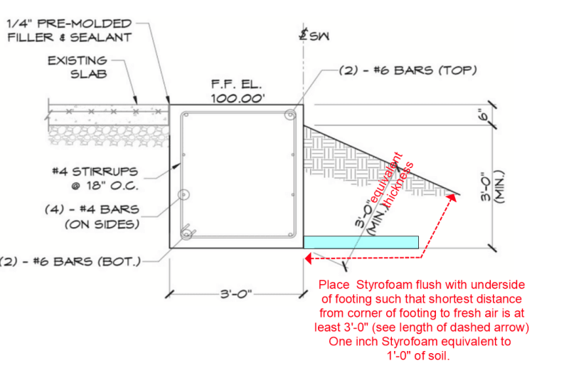

Would the insulation need to extend all the way up to finish grade and be visible? Or would we be able to conceal it under grade a bit?
No! Yes! Just provide the equivalent of 3'-0" earth cover assuming one inch of Styrofoam is equivalent to one foot of earth. See below.

Thank you BA, that is a good suggestion.
If your slope is 42" over 8', then I show the bottom of the footing being 2'-9" below grade (perpendicular to grade) when finished grade is 36" above the bottom of the footing. If possible, could you just specify 3'-6" minimum (vertically) to make it easy for the guy in the field, either by raising grade or lowering the bottom of footing?
