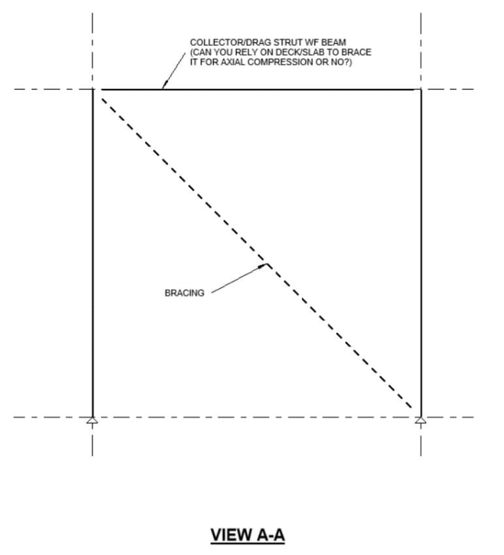

Can you rely on a slab-on-metal deck or a roof deck to prevent weak axis bucking of a steel beam? Specifically when you have a WF beam in line with a brace and the beam is acting as a drag strut, whether its at the roof or a floor level. Let's assume framing is running parallel to this beam, so you don't have any members framing into it. This beam will need to carry an axial compression load under certain lateral loading conditions.

Yes, my question is: does bracing one flange of a WF section cause sufficient restraint to consider it fully braced in axial compression?

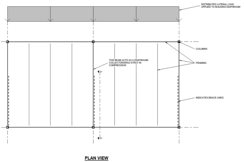

Certain loading conditions means if the lateral load is going in one direction on the building, let's say from north-to-south, the drag strut will be in axial compression. If the lateral load was going the other direction, let's say from south-to-north, the drag strut would be in axial tension and we wouldn't have a axial bracing issue. The main question I have is the one that XR250 more succinctly described.
Diagram of situation:

In your picture above: I would not consider those collectors to be fully braced. Top flange would be braced by the deck running perpendicular. I'd recommend adding kickers to the bottom flange at 6ft o.c. or so.
