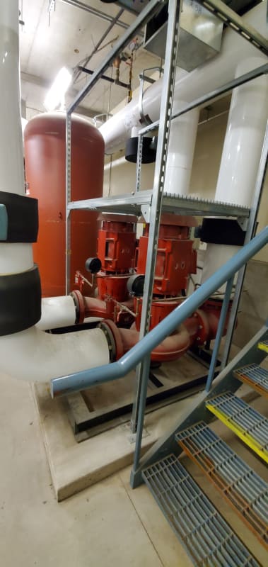

Hi folks, I am looking for some assistance with a hydronic system that serves our chiller plant. We have 3 chillers served by two dry coolers. The condenser loop is a closed loop system and uses 30% ethylene glycol.
The loop temperature is 45F in the winter and goes as high as 110F in the summer.
The condenser loop is equipped with a AMTROL bladder type expansion tank (see cut sheet attached). The expansion tank is installed close to the inlet of the pumps. The air side pressure at the expansion tank reads 11-12 PSI yet the pressure gauge where the expansion tank connects to the system reads -7 PSI when the pumps are running. When the pumps are off the pressure reading is 0 to 4 PSI
I don’t understand why there is a large discrepancy in pressure readings. Literature indicates that the pressure on air and liquid side of the expansion tank should be identical or close to each other.
The condenser pumps are not operating smoothly and are very noisy, most likely they are cavitating. The fact that the suction header is negative results in air being drawn in through the glycol feeder and the air vents, so we’ve isolated both devices with ball valves.
I have also attached a mechanical schematic. We've tested for leaks in the system and haven't found any.
Any ideas what to look for next? Also reached out to Amtrol but they haven't been very helpful.

I have verified the connection. It is on the suction side of the pumps. You can see it on the photo below.
What is really puzzling to me is why is the air side pressure so different from the water side pressure.
Suspect that's because the expansion tank has no water in it. Then the bladder can't expand anymore but will be at a higher pressure than the water.

Regarding the picture, the right side of the photo shows two suction lines coming off the header and going to the pump. In the background you can see the expansion tank and a black line connecting the tank to the suction header.
as little inch has said, the expansion tank with the pump running will be empty, but showing the charge pressure above the diaphragm, so there is no correlation between the 2 pressures.
The -7 psi in the inlet pipe work seems odd to me as I would expect for an installation as such the suction pressure would be positive - what are the relative levels between the evap. coolers and the pump centreline?
I'm >90% convinced this is your issue.
12psi is the factory pre-charge if you look at your data sheet. Therefore for me the bladder is taking up the full volume of the tank.

@Artsi, the fluid coolers are actually lower than the pumps. If I had to estimate, about 15' to 20' lower than the pump center line.
@littleinch, there is a PRV its kinda hard to see in the photo but if you look close enough its on the expansion tank connection piping. The operating manual just consists of equipment cut sheets and shop drawings, the contractor didn't really provide any procedures.
@TBP relief valves are set for 30 PSI. They haven't gone off though
We began looking at the system this year when we noticed the pumps were very noisy. The distance between the fluid coolers and the chiller plant is quite a bit so the system contains about 16000 gallons of glycol in it. The operators have over the summer added 2000 gallons of (expensive) glycol but the pressure still hasn't built up in the piping. At first, I thought the glycol is just ending up in the expansion tank and the bladder keeps filling up- but the air side pressure hasn't changed and actually doesn't change whether the system is running or off, which suggests that the bladder is basically fully squeezed and the glycol side pressure is still too low despite the addition of glycol.
There's about 200' of piping that's underground so there is a possibility that there is a leak somewhere but we've done tests where the operators have isolated the fluid coolers and all other equipment (chillers, HX) and used an air compressor to pressurize the pipes but the pressure doesn't actually drop
