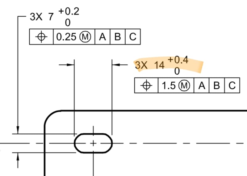

Consider fig. 7-34 of Y14.5-2009 or 10-35 of Y14.5-2018.
My first question is - would you say that the position tolerance applied on the 14mm length of slot dimension could be interpretable/inspectable if the position tolerance was applied at RFS, or handled according to the center plane interpretation of MMC?
And the second question is, how would you construct the MMC boundary had the end radii of the slot weren't tangent to the horizontal parallel surfaces and dimensioned by directly toleranced radii? For example 6X R8+/-0.2

I am asking about a slot but actually, I am interested generally in the application of position on features of similar shape. For example, rather than a slot, it could have been an external feature such as a tab with rounded ends, that assembles into a slot-shaped pocket in a mating part. Position at MMC on the length dimensions on both parts could be considered to protect boundaries that ensure the ability to assemble and provide additional tolerance for departure from MMC. The standard shows the boundary/surface interpretation but if hard gaging is not desired, I guess someone may think of applying the center plane interpretation, to inspect with CMM.

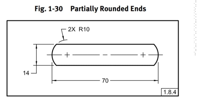

I agree that the value of the radii is not directly toleranced (or dimensioned) in this case. But the requirement for a regular feature of size is that it is "associated with a directly toleranced dimension". Aren't the ends of the slot and the 14mm dimension associated with each other? And again, the feature of size in question could be not the complete radii but "two opposed parallel (line) elements".
Also, as I alluded to in my second question, with a slightly different shape the value of the radii could be directly toleranced. Example:
The two 10mm radii could be specified with +/- tolerance. But even if the radii were basic and controlled by profile they could still be considered as "a directly toleranced feature or collection of features".

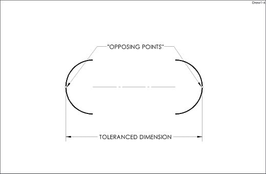

Let's back up... The idea being discussed for now is whether Rule #1 applies to control the form of the rounded radii. And we know that Rule #1 only applies for a regular FOS. So in the pictures being presented (2009's Figure 7-34 or your Figure 1-30), are the rounded ends considered a regular FOS?
There seem to be two tolerances involved: the radius and the distance across the slot:
The radius -- even if toleranced -- is not a regular FOS (no opposing elements).
The distance across might be a regular FOS, but that doesn't control the form of the radii because it's just speaking to the tangent points.
It seems that you're trying to combine those two ideas in order to call the radii a regular FOS. That's where I would disagree.

Belanger, I never suggested that each radius separately is a regular feature of size. I suggested that the length of the slot (the distance across the slot as you call it) may be considered a regular (or irregular) feature of size - and per your last reply, I suppose that you agree ("The distance across might be a regular FOS"). If it's a regular FOS (which I think is supported by the wording of the definition in the standard), then rule #1 applies to it. The way I would interpret the rule #1 requirement for the slots in fig. 7-34 of Y14.5-2009 or 10-35 of Y14.5-2018, is an envelope of two parallel planes 14 mm apart, fitted inside the slot. The requirement is met if a condition is achieved where both of the extremities of the slot which are specified with the dimension 14+0.4/0 are simultaneously outside of the space that is captured between those parallel planes.
I said that the distance across might indeed be a regular FOS, but does it really control the form? How can you control the form of two points??
So I still disagree about lumping the FOS (of the distance across) together with the radius and saying that it controls form.
I don't have a great answer to the question -- I'm just expressing my hesitancy about throwing Rule #1 into the discussion.
