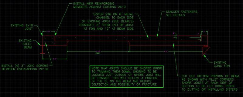

We have a client that has a golf simulator in their basement and wants to reduce the depth of the joists overhead so they could swing. Currently, there are 2x10s spanning 13' clear span. I ran numbers and a 2x6 sistered to each side of the joist full length works for the residential loading. Master bedroom is above. He is looking to cut the joist down to about 5.25 inches (the depth of a 2x6). I've included a drawing. My main question is developing the connections at the left side of the image attached, near the beam. I currently have 1' of development but am not sure about it. I have the screws spaced at 6" staggered.

2) Your concern for the 1' "development" length is justified in my opinion. I'd be surprised if that got the job done.
3) In this context, "development" = a connection with both moment and shear capability. I feel that the connections should be designed explicitly for those demands. In this thread, among others, I've done a reasonable job of articulating my own, personal view on how this is best handled. As always, there's more than one way to skin a cat.

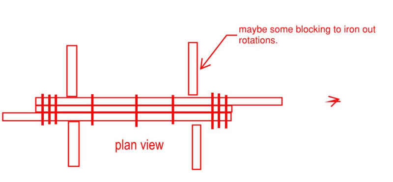

4) Given that you already plan to sister on two sides, I'd give some serious thought to the solution shown in the second sketch below. Numbers scmumbers; it's tough to beat actually taking the new pieces out to bearing.
I like the idea of blocking, I think I'm going to reduce the length of the cut down beam to allow for development.

On what basis were the staggered nailing between the 2x6 and 2x10 designed?
I believe that the nails, and their spacing has to be detailed to carry the maximum shear developed in the span. There is no moment transfer between the 2x10 and 2x6 joist. Is this correct?
Also, what is the purpose of the nails to the end of the 2x10 original joists?
These nails are not connecting any new element to the existing joist.
So what is their purpose/design?
