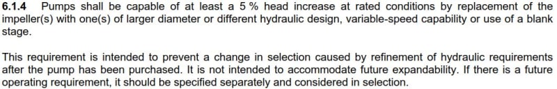

- Do we still need to apply 5% margin on the estimated shut off conditions in accordance with API 610 section 6.1.4 to account for slight variations in impeller hydraulic design or variable speed capability?
Process would typically specify their requirements of flow and head requirements as per system design. process normally doesnt consider this 5% margin to be considered in system design. during offer evaluation, mechanical engineer ensure that this 5% margin is available during pump selection based on operating point.
