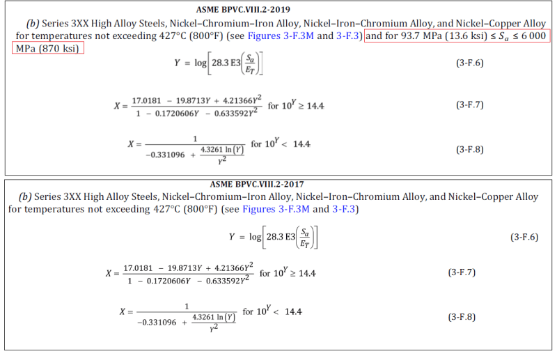

Please see the attached PDF. I'm assessing fatigue for a stress cut line in a low stress location using ASME v2017, Sec. VIII, Div. 2, Eqn 3-F.8. The PDF lists the calculations for this stress cut line. I've double/triple checked the calculations, but am getting number of allowable cycles, N, is <1 and damage > 1. These results do not seem to make sense to me, but I don't know what went wrong in the calculations.
Are there singularity problems in the v2017 equations, as was the case in v2013?
 https://files.engineering.com/getfile.aspx?folder=c90257bf-cce7-4fd2-bcf5-2946923ddf58&file=Mathcad_-_10_Fatigue_Hand_Calc_.pdf
Please check your units. In Imperial units, the units of stress is ksi, not psi.
It has nothing to do with UNITS. As long as the elastic modulus and the stress are in the same units (psi for both) he is ok.
The thing is that the Eq. in 3-F.7 and 3-F.8 are for Sa which is larger than 13.6 ksi and smaller than 870ksi.
The 2017 Edition doesn't include this exemption but the 2019 does.
The stress is low and hence, you may not use the Eq. you better take a look at Figure 3-F.3
P.S
The Code do states that units shall be in KSI but from Mathematical point of view, it doesn't really matter.
Thank you. Yes, I double-checked my units and concluded that PSI was acceptable to use since they cancel out in the calculations. Everything from the FEA model was PSI, which is why I used that in my calculations. And yes, for my reporting in the project documents, I'm using KSI as is the custom.
Thank you for sharing the excerpt added in v2019. That clears it up.
