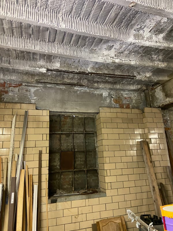

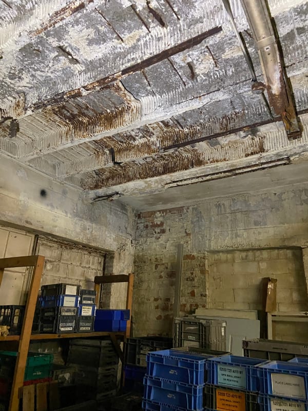

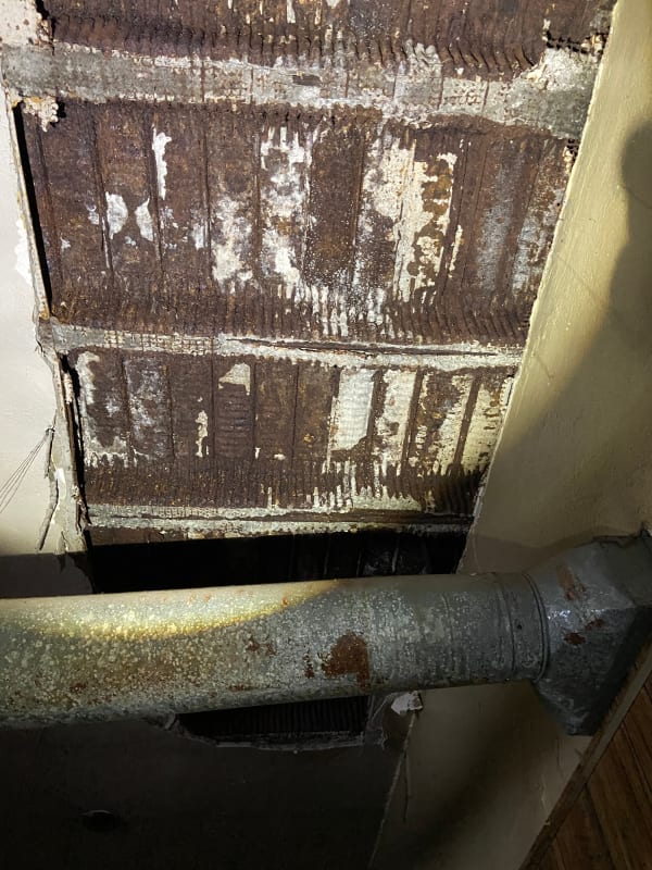

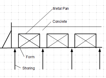

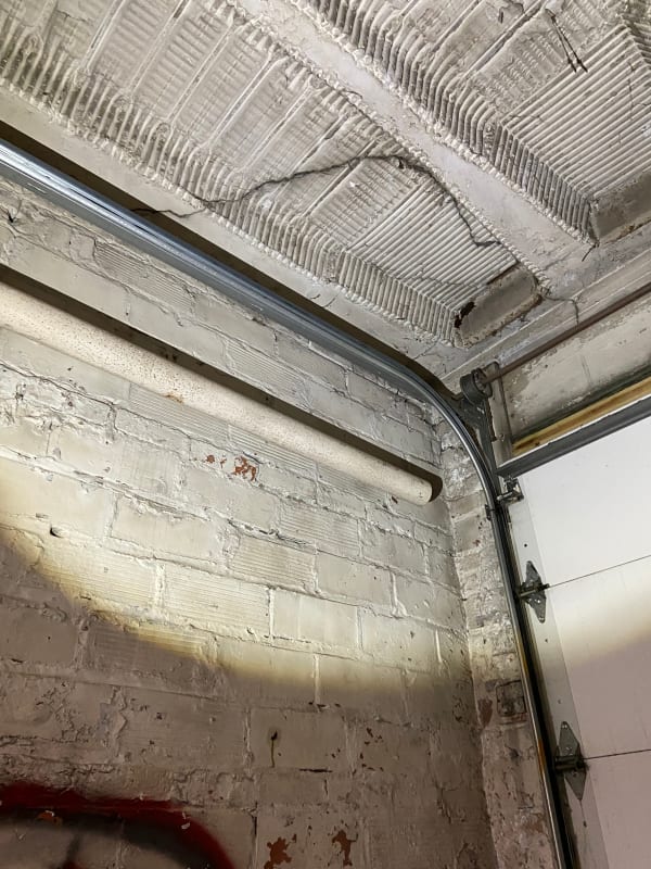

Another inspection, another weird floor system. This appears to be a metal pan form with concrete infill, making up concrete joists inbetween. Its got a ribbed texture.
Anyone know what its called?
